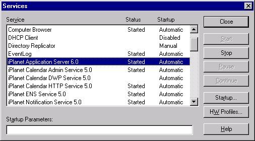

Double click Services. You will see the screen shown in Figure 2- 1.
- Settings > Control Panel.
Figure 2-1    The Services Screen ![]()
Highlight iPlanet Application Server 6.5 and click Startup.

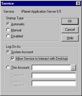

Figure 2-2    The Service Parameters Screen ![]()
Turn on the Allow Service to Interact with Desktop flag (see arrow 1), and click OK. This returns you to the Services screen (Figure 2 -1).
Click on the Stop button.

Tip If you prefer to manually start the server instead of automatically starting it at system startup, you can also select the Manual option in the Startup Type box (see arrow 2 in Figure 2-2).

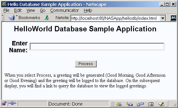

Your hellodb application is now installed and ready to be executed.Enter the number of the network port used by your web server in place of the [PORT_NUMBER], and enter this URL:
http://127.0.0.1:[PORT_NUMBER]/NASApp/hellodb/index.html
You will see the screen shown in Figure 2 - 3.
Figure 2-3    HelloDB sample application ![]()
