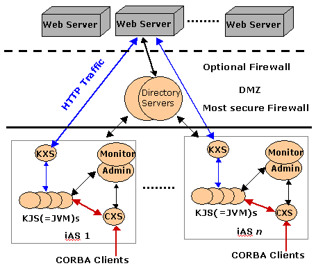

To achieve maximum performance, you need to understand the basic process architecture of iPlanet Application Server. A common iPlanet Application Server deployment scenario is shown below. For the sake of clarity, the figure depicts only the traffic from one web server instance to iPlanet Application Server and Directory Server. The web server (or more precisely, the Web-Connector Plugin) manages the load balancing of requests to all the nodes configured in iPlanet Application Server cluster, as shown in the figure.
The multi-instance clustering architecture delivers superior horizontal scalability and high availability through replication of state on other application server instance nodes. Each instance can be configured with multiple KJS processes (each KJS process is a JVM instance) to achieve the desired degree of scalability. Each KJS process can be assigned multiple threads for processing, thereby increases performance.
The following illustration will help you understand how all the components of iPlanet Application Server fits together. The illustration shows how the various parts of iPlanet Application Server's process architecture are related to one another and the way they are connected to the web servers, and ultimately, to the users.
Figure 1-1
iPlanet Application Server process architecture
