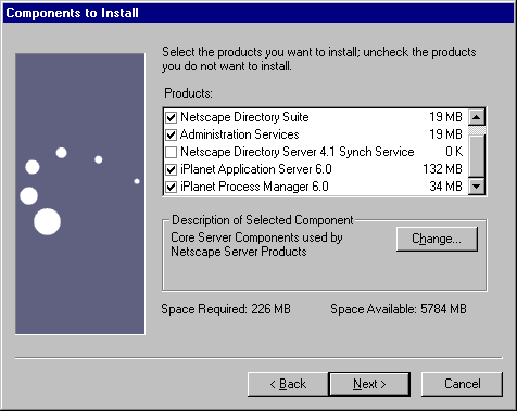

Select which components to install:
- The default directory is C:\iPlanet\iPM6.
- You cannot use a directory name that includes spaces.
- To install Process Manager along with iPlanet Application Server and Directory Server, select all the following components (these are the default selections):
- The first three components (Netscape Server Family Core Components, Netscape Directory Suite, Administration Services) install Directory Server software.
- To install Process Manager along with Netscape Application Server without Directory Server, select
- To install only Process Manager Server 6.0 and Process Builder 6.0 select only
iPlanet Process Manager 6.0
- To install Process Manager Server without the Web Connector, for a webless install, select
iPlanet Application Server 6.0 and click Change
Deselect the Web Connector Plug-in component and click Continue.
- Once your webless installation is complete, you must install the Web Connector Plugin on your Web Server machine. See the section "Webless Installation" to update the webserver instance you plan on using with the Application Server.
- To install only Process Manager Server 6.0 or Process Builder 6.0, select
iPlanet Process Manager 6.0 and click Change.
- Deselect the component you do not want to install and click Continue. If you are installing only Process Builder, click Next to complete the installation process. If you are installing only Process Manager server, click next to Enter Information for Process Manager.

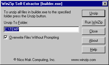

Installing Process Builder Only
You can install the Process Builder as a stand-alone tool on your system. Note that if you install Process Manager 6.0, Process Builder is installed by default; you do not need to install Process Builder separately. However, if you want to install only Process Builder, perform the following steps:
Locate the builder.exe file on the CD or download it from the Process Manager ftp site.
Double-click the builder.exe file.
Enter the directory where the self-extractor will extract the files.
Click OK in the dialog box that appears indicating that the files were extracted successfully.
- The Process Builder files are extracted into the directory you specified in Step 3.
Click Close in the self-extractor window.
Navigate to the directory you specified in Step 3 and open the builder folder.
Double-click the Builder.exe file.
- Process Builder appears.
- Alternatively, you can double-click the Builder.bat file to launch a separate DOS window in addition to Process Builder that displays diagnostic messages. Note that if you close this DOS window, Process Builder closes as well.
