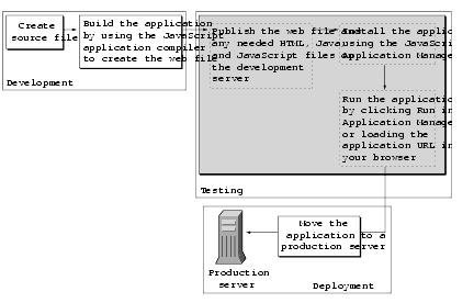

You take these basic steps to build a JavaScript application:
Create the source files. The source files can be HTML files with embedded JavaScript, files containing only JavaScript, or Java source files. (See "Creating Application Source Files.")
Before you can develop JavaScript applications, you need to enable the runtime engine on the server and should protect the JavaScript Application Manager from unauthorized access. For more information, see "Configuration Information" and Chapter 2 "Getting Started."
Build the application by using the JavaScript application compiler to create the bytecode executable (.web file). (See "Compiling an Application.") Compile Java source files into class files.
- Note that the JavaScript VM used in iPlanet Web Server 4.1 implements significant improvements in the processing of local variables (that is, variables that are declared inside a function) as compared to NES 3.6. Therefore it is suggested that use of global variables (that is, variables that are declared between the <server> and </server> tags) be minimized and applications be rewritten to use functions as much as possible. This can improve the application performance significantly.
Publish the web file, any needed uncompiled HTML, image, and client-side JavaScript files, and compiled Java class files in appropriate directories on the server. You can use the Netscape Web Publisher to publish your files, as described in the Web Publisher User's Guide.
Install the application for the first time (see "Installing a New Application.") using the JavaScript Application Manager. You also use the Application Manager to restart an application after rebuilding it (see "Starting, Stopping, and Restarting an Application."). Installing or restarting the application enables the JavaScript runtime engine to run it.
After installing an application, you may want to protect it. See "Deploying an Application." You do not need to restart an application after you initially install it.
Run the application by clicking Run in the Application Manager or loading the application URL in your browser. (See "Running an Application" and "Application URLs") For example, to run Hello World, load http://server.domain/world/. You can also debug the application by clicking Debug in the Application Manager. (See "Debugging an Application.")
After you have completed developing and testing your application, you need to deploy it to make it available to users. Deploying generally involves installing it on a production server and changing access restrictions. (See "Deploying an Application.")

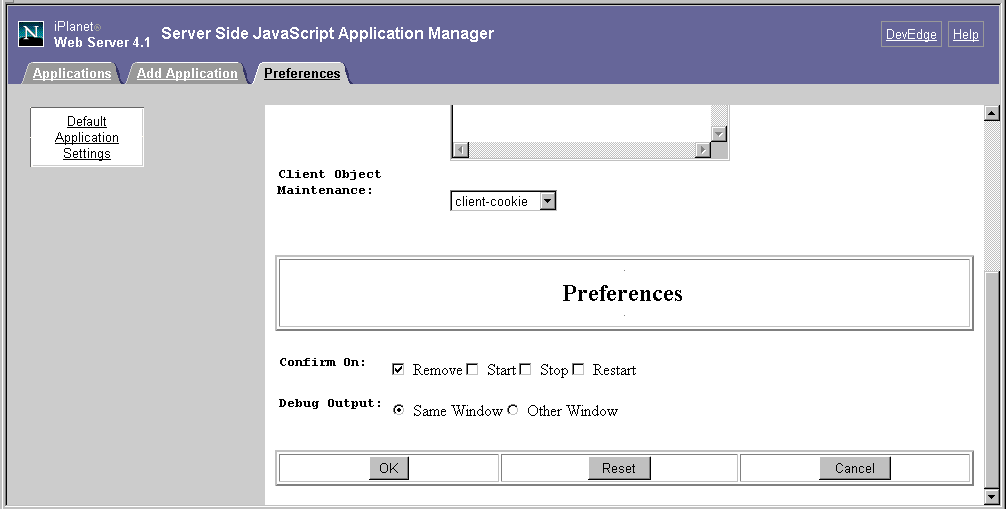

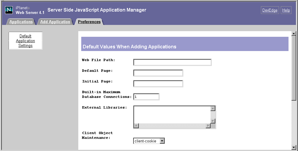

Click Configure (in Enterprise Server 3.x) or Preferences (in iPlanet Web Server 4.1) to configure the default settings for the Application Manager.

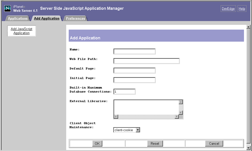

To install a new application with the Application Manager, click Add Application. In response, the Application Manager displays, in its right frame, the form shown in Figure 3-4. (The color scheme is different in iPlanet Web Server 4.1.)
Figure 3-4    Add Application form ![]()
Fill in the fields in the Add Application form, as follows:
Name: the name of the application. This name defines the application URL. For example, the name of the Hello World application is "world," and its application URL is http://server.domain/world. This is a required field, and the name you type must be different from all other application names on the server. See "Application URLs."
After you have provided all the required information, click Enter to install the application, Reset to clear all the fields, or Cancel to cancel the operation.Web File Path: the full pathname of the application web file. This is a required field. For example, if you installed the Netscape server in c:\nshome, the web file path for the Hello World application is c:\nshome\plugins\samples\js\world\hello.web.
Default Page: the page that the JavaScript runtime engine serves if the user does not indicate a specific page in the application. This page is analogous to index.html for a standard URL.
Initial Page: the page that the JavaScript runtime engine executes when you start the application in the Application Manager. This page is executed exactly once per running of the application. It is generally used to initialize values, create locks, and establish database connections. Any JavaScript source on this page cannot use either of the predefined request or client objects. This is an optional field.
Built-in Maximum Database Connections: the default value for the maximum number of database connections that this application can have at one time using the predefined database object. (This is provided for backward compatibility with applications that use database objects; for new applications that use a dbpool object, ignore this field. See "Database Connection Pools for how to set this parameter for a dbpool object.)
External Libraries: the pathnames of external libraries to be used with the application. If you specify multiple libraries, delimit the names with either commas or semicolons. This is an optional field. Libraries installed for one application can be used by all applications on the server. See "Working with External Libraries."
Client Object Maintenance: the technique used to save the properties of the client object. This can be client cookie, client URL, server IP, server cookie, or server URL. See "Techniques for Maintaining the client Object."
You must stop and restart your server after you add or change the external libraries for an application. You can restart a server from your Server Manager; see the administrator's guide for your web server for more information.

This section shows how to change default settings for the Application Manager. In addition, it talks about the format of the underlying file in which the Application Manager stores information.
Configuring Default Settings
To configure default settings for the Application Manager, click Configure (in Enterprise Server 3.x) or Preferences (in iPlanet Web Server 4.1) in the Application Manager's top frame. In response, the Application Manager displays the form shown in Figure 3-6.You can specify these default values:
Web File Path: A default directory path for your development area.
When you install a new application, the default installation fields are used for the initial settings.Default Page: A default name for the default page of a new application.
Initial Page: A default name for the initial page of a new application.
Built-in Maximum Database Connections: A default value for the maximum number of database connections you can make for the predefined database object. (This is provided for backward compatibility with applications that use database objects; for new applications that use a dbpool object, ignore this field. See "Database Connection Pools" for how to set this parameter for a dbpool object.)
External Libraries: A default directory path for native executables libraries.
Client Object Maintenance: A default maintenance technique for the client object properties.
Figure 3-6    Default Settings form ![]()
In addition, you can specify these preferences, shown in Figure 3-7:
Confirm on: Whether you are prompted to confirm your action when you remove, start, stop, or restart an application.
Debug Output: Whether, when debugging an application, the application trace appears in the same window as the application but in another frame, or in a window separate from the application.
Figure 3-7    Default Settings form with Preferences shown ![]()
