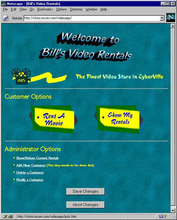

After connecting to the database, the Application Manager displays the videoapp home page, as shown in Figure 13-1.
Figure 13-1    Videoapp home page ![]()
If you cannot connect to the database, you see an error message. Make sure you have entered the correct database connection parameters as described in "Connecting to the Database and Recompiling" recompiled, and restarted the application.
The first thing you must do when you're connected is to add a new customer. Until you have done this, there are no customers to use for any of the other activities.
