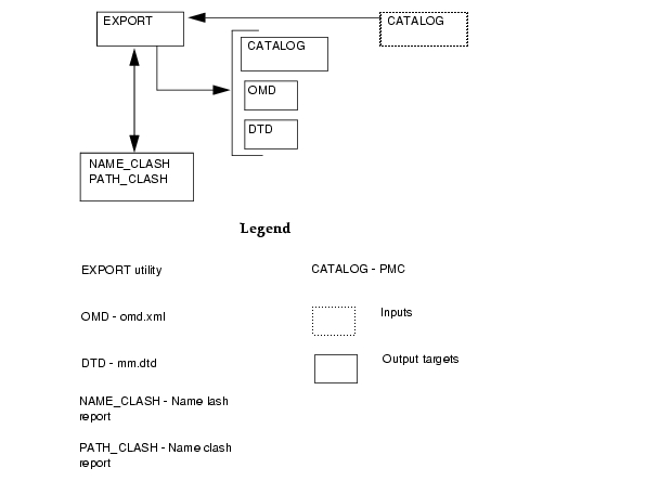

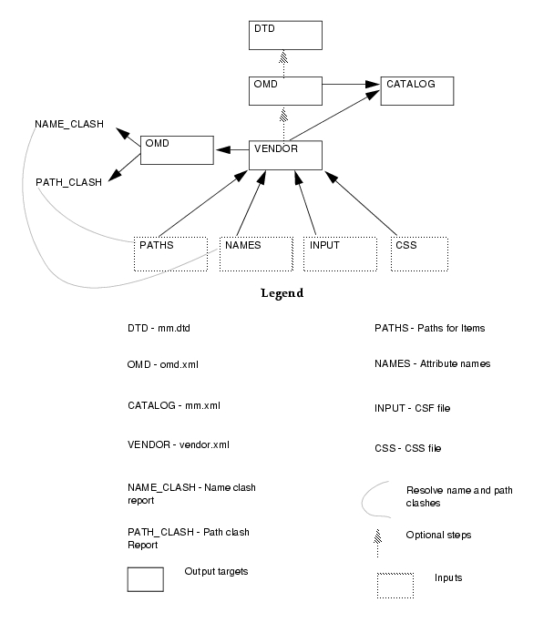

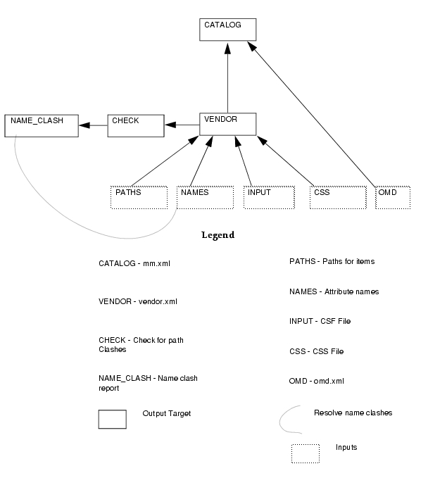

Dependency Trees
After you create CSF and CSS files, you are ready to specify the information that the Import utility needs to create the load file to load in the Public Master catalog (PMC).
The Import utility uses the make command to create the load file. The make command inputs and the output targets are shown as dependency trees in Figure 3-1 and Figure 3-2. Figure 3-1 shows the dependency tree to create a seller ontology when there is not an exiting PMC ontology. Figure 3-2 shows the dependency tree to update an existing PMC ontology.
Figure 3-1    Dependency Tree for Creating a Seller Ontology with No Existing PMC Ontology
Figure 3-2    Dependency Tree for Updating an Existing PMC Ontology

Exporting Catalogs
In addition to importing catalogs, you can also export them. You might want to export catalogs for the following reasons.
  • To use the Export utility to provide the existing PMC ontology information to a new seller who wants to import a new catalog. The new seller can use the omd.xml file generated by the Export utility to ensure that the new seller catalog ontology matches the exiting PMC ontology.
  • The Export utility lets you export a seller catalog for backup and archiving purposes.
Given an existing PMC, you can export an mm.xml file that contains the catalog information for a specified seller. If there are name or path clash violations after your first Export utility run, you must specify the -n or -p options to resolve the violations the next time you run the Export utility. If there are no name and path clashes after subsequent Export utility runs, the name or path clash report files are empty.
For more information about name and path clashes, see the "Detecting Clashes" section in Chapter 3.
The Export utility outputs mm.dtd, mm.xml, omd.xml, and name and path clash files. See Figure 3-10.
Figure 3-10    Export Utility Flow
Running the Export Utility
To export an mm.xml seller catalog file from the catalog database, use one of the following commands:
run -xms64M -Xmx512M com.iplanet.ecommerce.vortex.catalogtools.export.Main [inputs]
Or:
$IMM_HOME/catalogtools/bin/export_cat.sh
The inputs to this command line are described in the following table. The required inputs to the loader are in bold in the left column in Table 3-11.
Table 3-11    Inputs to the Export Utility Command Line
Export Utility Input
Definiton
