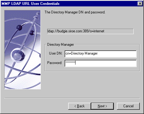

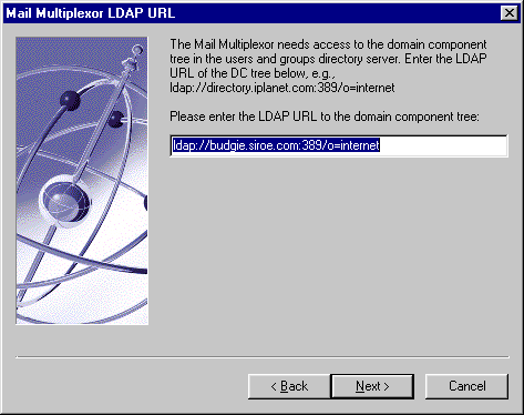

MMP LDAP URL User Credentials
- Enter the LDAP URL of the DC tree so that the MMP will be able to access the DC tree in the Users and Groups Directory Server. This is usually in the following format: ldap://user-group_directory_server_hostname>:port/o=internet
- Enter the Bind DN and password of the Directory Manager or any LDAP user with read access to the Users and Groups Directory.

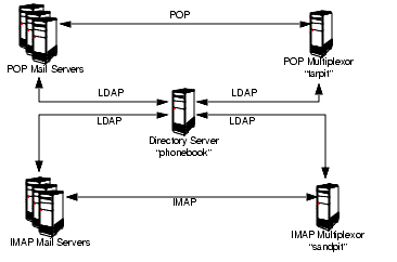

Sample Messaging Topology
The fictional Siroe Corporation has two Multiplexors on separate machines, each supporting several Messaging Servers. POP and IMAP user mailboxes are split across the Messaging Server machines, with each server dedicated exclusively to POP or exclusively to IMAP. (You can restrict client access to POP services alone by removing the IMAP-server binary; likewise, you can restrict client access to IMAP services alone by removing the POP-server binary.) Each Multiplexor also supports only POP or only IMAP. The LDAP directory service is on a separate, dedicated machine.This topology is illustrated below in Figure 4-1.
Figure 4-1    Multiple MMPs Supporting Multiple Messaging Servers
IMAP Configuration Example
The IMAP Multiplexor in Figure 4-1 is installed on sandpit, a machine with two processors. This Multiplexor is listening to the standard port for IMAP connections (143). Multiplexor communicates with the LDAP server on the host phonebook for user mailbox information, and it routes the connection to the appropriate IMAP server. It overrides the IMAP capability string, provides a virtual domain file, and supports SSL communications.This is its ImapProxyAService.cfg configuration file:
POP Configuration Example
The POP Multiplexor example in Figure 4-1 is installed on tarpit, a machine with four processors. This Multiplexor is listening to the standard port for POP connections (110). Multiplexor communicates with the LDAP server on the host phonebook for user mailbox information, and it routes the connection to the appropriate POP server. It also provides a spoof message file.This is its PopProxyAService.cfg configuration file:
