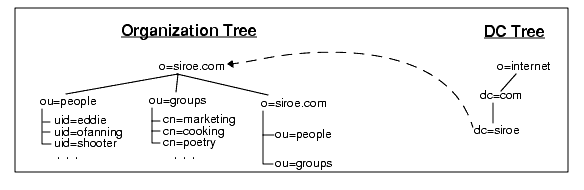

Mapping an Netscape Messaging Server Namespace with a Single Domain to an iPlanet Messaging Server Namespace

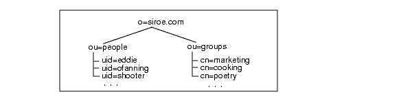

To describe how to map a Netscape Messaging Server namespace with a single domain to the iPlanet Messaging Server namespace, let us start by showing a simplified example of an Netscape Messaging Server namespace with a single domain (Figure B-1).
Figure B-1    Netscape Messaging Server Single Domain Namespace

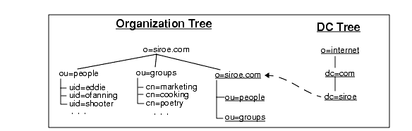

When the iPlanet Messaging Server is installed (Figure B-2) three things relating to namespace mapping occur: 1) A DC Tree with a default domain node is created; 2) An empty default domain is created in the Organization Tree; 3) The inetDomainBaseDN attribute in DC Tree's default domain entry is set to the default domain node in the Organization Tree. (inetDomainBaseDN is the DN of the organization subtree where all user/group entries are stored.)
Figure B-2    Single-domain Namespace after iPlanet Messaging Server is Installed (underscored nodes created by install program)
The iPlanet Messaging Server will not work in this configuration because the DC Tree needs to be mapped to the Organization Tree where the user and group entries exist. This involves setting the inetDomainBaseDN in the DC Tree domain entry to point to the organization subtree containing the user and group data.
Using our example, the simplest way to map the Netscape Messaging Server namespace to the iPlanet Messaging Server namespace is shown in Figure B-3.
Figure B-3    Single-domain Netscape Messaging Server Namespace Mapped to iPlanet Messaging Server NamespaceDelegated Administrator and Hosted Domains Not Supported
In this example, we changed the attribute-value pair in the DC Tree domain node entry dc=siroe,dc=com,o=internet from
inetDomainBaseDN: o=siroe.com,o=siroe.com
to
inetDomainBaseDN: o=siroe.com.
This can be done with following LDIF change file:dn: dc=siroe,dc=com,o=internet
changetype: modify
replace: inetdomainbasedn
inetDomainBaseDN: o=siroe.comWhile this namespace configuration will work with the iPlanet Messaging Server, it will not support Delegated Administrator or hosted domains. To support Delegated Administrator and hosted domains, user and group entries must be moved into the organization subtree node, and the inetDomainBaseDN attribute in the DC Tree domain node needs to be reset as shown in Figure B-4.

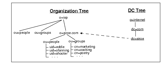

Figure B-4    Single-domain Netscape Messaging Server Namespace Mapped to iPlanet Messaging Server NamespaceDelegated Administrator and Hosted Domains Supported
In this example we did the following:
In the Organization Tree we changed root suffix to o=siroe.com to o=isp. While this wasn't operationally necessary, it makes the Organization Tree more standard.
This namespace configuration will now support Delegated Administrator and hosted domains.In the Organization Tree we moved user and group entries from ou=people,o=siroe.com and ou=groups,o=siroe.com to ou=people,o=siroe.com,o=isp and ou=group,o=siroe.com,o=isp.
In the DC Tree entry dc=siroe,dc=com,o=internet we replaced the existing inetDomainBaseDN attribute value pair with
inetDomainBaseDN: o=siroe.com,o=ispBefore installing the iPlanet Delegated Administrator for Messaging, add the appropriate ACIs. To add Delegated Administrator functionality, run the imsdaaci command (packaged with the migration toolkit). This generates an LDIF file that can be used to create a Delegated Administrator Service Administrator Group and Delegated Administrator Domain Administrator Group along with the required ACIs.
server_root/bin/msg/migrate/bin/imsdaaci
Use ldapmodify to add the LDIF file into the DIT. For an explanation of the ACIs refer to the iPlanet Messaging Server Provisioning Guide

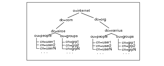

Mapping a Netscape Messaging Server Namespace with Multiple Domains to an iPlanet Messaging Server Namespace

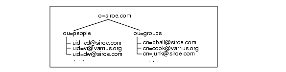

To describe how to map a Netscape Messaging Server namespace with multiple domains to the iPlanet Messaging Server namespace, let us start by showing a simplified example of a Netscape Messaging Server namespace with multiple domains (Figure B-5).
Figure B-5    Netscape Messaging Server Multiple Domain Namespace

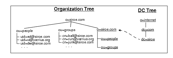

When the iPlanet Messaging Server is installed (Figure B-6) three things relating to namespace mapping occur: 1) A DC Tree with a default domain node is created; 2) An empty default domain is created in the Organization Tree; 3) The inetDomainBaseDN attribute in DC Tree's default domain entry is set to the default domain node in the Organization Tree. (inetDomainBaseDN is the DN of the organization subtree where all user/group entries are stored.)
Figure B-6    Multiple-domain Namespace after iPlanet Messaging Server is Installed (underscored nodes created by install program)
The iPlanet Messaging Server will not work in this configuration because the DC Tree needs to be mapped to the Organization Tree where the user and group entries exist. This involves two steps: 1) For each domain in the Organization Tree, a corresponding domain node in the DC Tree must be created; 2) The inetDomainBaseDN attribute in each DC Tree domain entry must be set to the organization subtree containing the user and group data.

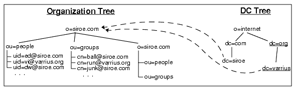

Using our example, the simplest way to map the Netscape Messaging Server namespace to the iPlanet Messaging Server namespace is shown in Figure B-7.
Figure B-7    Simple Multiple-domain Netscape Messaging Server Namespace Mapping to iPlanet Messaging Server NamespaceDelegated Administrator and Hosted Domains Not Supported (underscored nodes created by administrator)
In this example, we created a new DC Tree domain node called dc=varrius,dc=org,o=internet. (See the iPlanet Messaging Server Provisioning Guide for details on how to do this.) We also replaced the inetDomainBaseDN attribute-value pair in dc=siroe,dc=com,o=internet and dc=varrius,dc=org,o=internet with inetDomainBaseDN: o=siroe.com

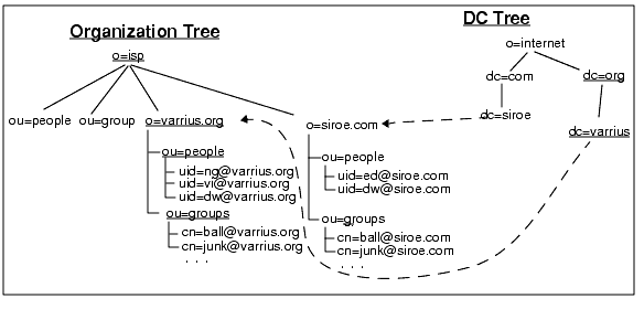

Figure B-8    Multiple-domain Netscape Messaging Server Namespace Mapped to DC Tree in the iPlanet Messaging Server NamespaceDelegated Administrator and Hosted Domains Supported (underscored nodes created/changed by administrator)
In the Organization Tree we changed root suffix from o=siroe.com to o=isp. While this wasn't operationally necessary, it makes the Organization Tree more standard.
This namespace configuration will now support Delegated Administrator and hosted domains. To add Delegated Administrator functionality, run the imsdaaci command (packaged with the migration toolkit). This generates an LDIF file that can be used to create a Delegated Administrator Service Administrator Group and Delegated Administrator Domain Administrator Group along with the required ACIs.In the Organization Tree we created the subtree o=varrius.org,o=isp as well as two containers, ou=people and ou=groups. (See the iPlanet Messaging Server Provisioning Guide for information on how to create domains and containers.)
In the Organization Tree we moved user and group entries from ou=people,o=siroe.com and ou=groups,o=siroe.com to the people and group containers in varrius.org and siroe.com
In the DC Tree, we created the domain nodes dc=org,o=internet and dc=varrius,dc=org,o=internet
In the domain node entries dc=siroe,dc=com,o=internet and dc=varrius,dc=org,o=internet we added the attribute value pair inetDomainBaseDN: o=siroe.com,o=isp and inetDomainBaseDN: o=varrius.org,o=isp.
