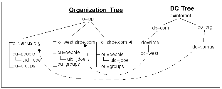

In this example, data entries are added and modified under the Organization Tree, but the message server actually references the DC Tree. Let's consider three users:
User 1
User 2
User 3
Name:
John Doe
John Doe
Jane Doe
Domain:
siroe.com
west.siroe.com
varrius.org
UID:
jdoe
jdoe
jdoe
Login:
jdoe@siroe.com
jdoe@west.siroe.com
jdoe@varrius.org
The login is derived from the UID and domain. In each of these cases, the server looks at the domain part of the login (the value after the @ sign) and retrieves the DN from the inetdomainbasedn attribute of the corresponding DC node. It then searches the subtree pointed at by the DN for a user entry where the UID equals the local part of the login (the value before the @ sign).
John Doe in west.siroe.com logs into the server using the login jdoe@west.siroe.com. The server follows the DN reference (inetdomainbasedn) in the DC node for west.siroe.com over to the subtree o=west.siroe.com, o=isp. It then searches for a user entry where the uid=jdoe in this subtree.

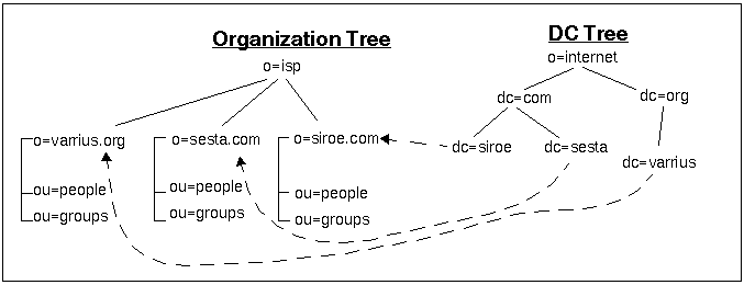

Mapping an Existing DIT to iPlanet Messaging Server
The two-tree mechanism allows mapping existing DITs to the iPlanet Messaging Server. This is shown in the figure below which depicts an existing NMS DIT (o=siroe.com) mapped to a DC Tree in the iPlanet Messaging Server. This process is described in detail in the iPlanet Messaging Server Migration Guide.
Figure 1-2    Mapping Existing DIT to iPlanet Messaging ServerExample ![]()

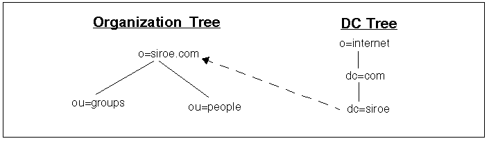

Partitioning Data for Access Control
The two-tree mechanism provides for data partitioning and access control within each partition. This feature is important in a multi-tenant directory since it is a strict requirement that one customer cannot access data pertaining to other customers stored in the same directory tree. Data partitioning and access control permit outsourcing of applications to distinct customer organizations in a secure manner such that user/group data for each organization can be stored separately from other organizations. An example of this type of application is the iPlanet Delegated Administrator for Messaging.For this reason, outsourced messaging customers are represented in a well-defined subtree (typically a domain) within the overall DIT. This subtree is used to store all service data belonging to the customer. This concept is depicted in Figure 1-3.
Figure 1-3    Partitioning Data for TEST Access ControlExample ![]()
Providing Distinct Namespaces for Subdomains
The two-tree mechanism provides distinct namespaces for subdomains. This allows the same login name to be used in subdomains, for example, jdoe@siroe.com and jdoe@west.siroe.com can be two separate and legal email addresses. This is shown in Figure 1-1.

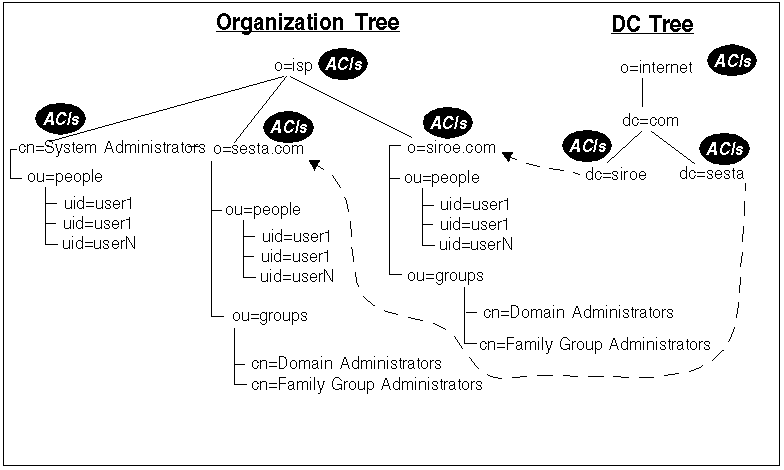

ACI Architecture
Access Control Information instructions (ACIs) control user access to the directory. There are several types of messaging server users which require different levels of access to the directory. Some of these user types are as follows:
Normal email user. This user type simply sends and receives email and requires such permissions as modifying password and starting vacation mode.
Each of these user types have specific ACIs assigned to them at the root or domain level of the DC and Organization Trees (Figure 1-4). By assigning ACIs in the root and domain entries instead of for each user, access can be scoped to a domain or to the entire system. Thus, ACIs specified on the root node will apply to entries in the entire system, while ACIs specified in a domain apply only to entries in that domain. (For detailed ACI information see the iPlanet Directory Administration Guide.)Top-level administrator has permission to do anything to any entry in the directory.
Message Store Administrator has permissions to view mailboxes and manage the message store for the system or domain.
Domain Administrator can create, modify and delete mail user, mailing list, and family account entries in a domain.
Domain Organization Administrator creates, modifies and deletes mail user and mailings list entries in a domain organization.
Family Group Administrator has permission to add and remove family members in a family group entry.
ACIs for the various administrators are conferred upon specific groups. To create an administrator you simply add a user to the group and add a group back pointer attribute (memberof) in the user entry. For example, at installation a group called cn=Domain Administrators, ou=groups, <DN of domain> is created with specific ACI privileges. To create a Domain Administrator, simply add a user to the group and add the memberof attribute to the user's entry.
To create a Family Group Administrator, a user is added to the mailing list
cn=Family Group Administrators, ou=groups, <DN of domain>
For complete instructions on creating administrators, see Chapter 6 "Provisioning Messaging Server Administrators."In the configuration shown below. ACIs will be specified in the following entries:
o=isp
o=sesta.com,o=isp
o=siroe.com,o=isp
o=internet
dc=siroe, dc=com, o=internet
dc=sesta, dc=com, o=internetThe ACIs installed for domains and root entry nodes are shown in Figure 1-4.
Figure 1-4    ACI Example ![]()
