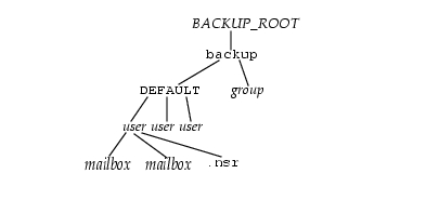

To use imsasm to save the mailbox INBOX for user joe, the system administrator creates a directory file backup_root/backup/DEFAULT/joe/.nsr with the following contents:
imsasm: INBOX
This causes the mailbox to be saved using imsasm. Executing the mkbackupdir utility will automatically create the .nsr file. See mkbackupdir.

The backup directory is created to contain the information necessary for Networker to backup the message store at different levels (server, group, user, and mailbox). Figure 1-1 displays the structure.
Figure 1-1    Backup directory hierarchy
Location: server_root/bin/msg/store/bin
The variables in the backup directory contents are:
The mkbackupdir utility creates:
A default group directory (ALL) or the group directories defined in the backup-groups.conf configuration file. The following is a sample backup-groups.conf file:
groupA=a*
groupB=b*
groupC=c*
A user directory under the backup directory for each new user in the message store.
A 0 length mailbox file for each mailbox.
A .nsr file for each subdirectory that contains user mailboxes. The .nsr file is the NSR configuration file that informs the Networker to invoke imsasm. imsasm then creates and interprets the data stream.
Each user mailbox contains files of zero length. This includes the INBOX, which is located under the user directory.
Note Make sure the backup directory is writable by the message store owner (mailsrv).
