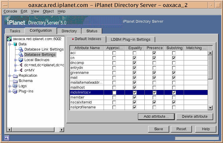

To Add Indexes From the Directory Server Console
To index attributes from the Directory Server 4.1x console, do the following:
Open the Directory Server console.
Navigate to the database index pane:
In the iPlanet Directory Server 5.0 console, choose the Configuration tab, expand the Data node, then select Database Settings in the navigation tree.
In the Netscape Directory Server 4.1x console, choose the Configuration tab and select the Database node in the navigation tree.
In the right-hand pane, click Add Attribute.
- The right-hand pane will display the attributes that are currently indexed.
Select the attribute name you want to index and click OK.
Select the indexes you want to create for the attribute (see Figure 4-1).
Repeat Steps 3 through 5 for each attribute listed in Table 4-1 and Table 4-2.
Figure 4-1    Adding Indexes for Meta-Directory Attributes ![]()
