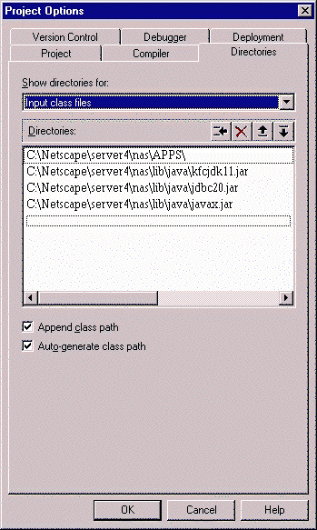

  3. Select the Directories tab of the Options dialog box, select "input class files" from the drop down list and add the following directories and jar files.
Note. Note that Visual Cafe provides a file browser so that you do not need to type in any file names directly.

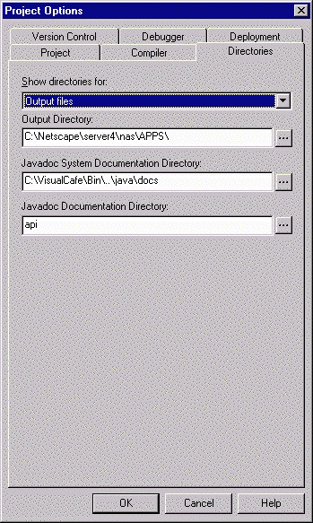

  1. Select "Output files" from the drop-down list and set the "Output Directory" to
  2. Choose OK and then save your Visual Cafe project.

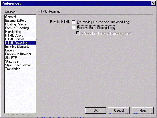

To ensure that Dreamweaver does not modify your HTML automatically:
  1. Open Dreamweaver.
  2. Select Preferences from the Edit menu.
  3. Select the HTML Rewriting category.
  4. Uncheck all items under Rewrite HTML.
Note. Although you can use Dreamweaver on files that contain GX tags, Dreamweaver does not recognize GX tags.
