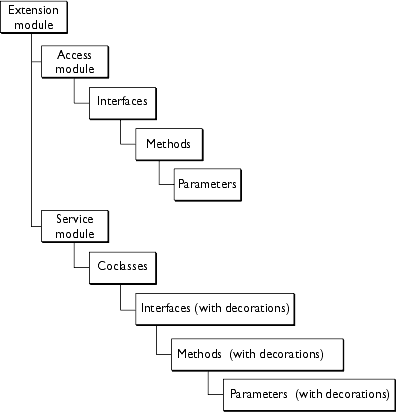

A Netscape extension is designed and built in parts, as depicted in the following illustration:
The top three levels are modules, or logical groupings, of an extension and the components within an extension. You design extensions within these modules, which are described in the following sections:
Each of the above modules corresponds to individual IDL files: one file for the extension, one file for each access module, and one file for each service module. KIDL is used in different ways depending on the module of the extension you are designing. The IDL files are then used as input to the KIDL Compiler, which creates the extension source code and method stubs. These concepts and procedures are described in later sections.
Extension Module
The extension module represents the extension as a whole. It is a grouping of the interfaces and services that compose the extension. The extension module contains the access module and the service module, and everything those modules contain.

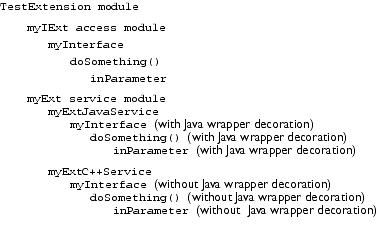

The service module is a grouping of coclasses. A coclass is a design specification of a class and becomes a class after the service module IDL file is compiled.
In the service module, coclasses typically implement one or more of the interfaces defined in the access module. When implementing those interfaces, you can add decorations to the interfaces, methods and parameters. Decorations describe a portion of the implementation details for how a coclass becomes a class. For example, a decoration can provide information to the KIDL Compiler that a certain interface is going to have a Java access layer that supports calls from Java application components.
Implementation details are not specified in the access module to simplify extension building and to support multiple interface implementation.
Multiple interface implementation allows for different implementations of the same interface. It is easier to assign decorations on a coclass basis, rather than define two interfaces, which would appear identical to the application component layer.
For example, you could define two coclasses that implement the same interface, but implement that interface in different ways. Within the service module you might have a Java version coclass called myExtJavaService as well as a C++ version coclass called myExtC++Service. Each coclass would implement the same interface. However, the implementation of the interface in the Java service would use a Java Access Layer decoration, whereas the C++ coclass implementation would not use the Java Access Layer decoration. This example is depicted in the following illustration:
