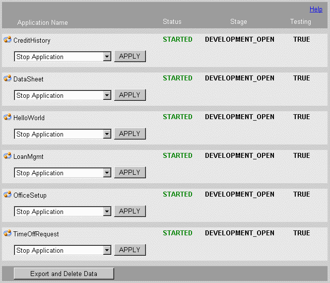

Designers use Process Builder to define a PAE application. When the application is complete, the designer can deploy it to a cluster for final testing or for normal production use by Process Express end users.
A deployed application consists of a process definition that is stored in the configuration directory and a set of user data stored in the cluster's database.
Once an application is deployed, Process Administrator maintains information about its state. As the administrator, you can change this information, and as you do so, Process Administrator keeps the application information up to date in the configuration directory.
Figure 4.1    The Deployed Applications page
Application states include both their status and their stage. An application's status indicates whether it is currently running or not. An application's stage indicates whether it is in development or production, and whether it is available to end users.
Application statuses are:
Administrators can stop started applications or start a stopped application.
Designers deploy to Development or Production. If they deploy to Development, they can still change almost all aspects of the application. If they deploy to Production, they are very limited in what changes they can make.

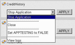

Stopping & Starting Applications
Among the actions that an administrator can perform on an application are stopping and starting it. These change its status, which is maintained in the configuration directory as part of the persistent application data that describes all instances of the application across the cluster.
Figure 4.2    Application administration actions
If an application is started and the administrator stops it, this shuts it down everywhere across the cluster. This sets the application's status to Stopped, which does not allow access to process instance detail by end users
If an application is stopped and the administrator starts it, this sets the application's status to Started, which allows full access to process instances and work items by end users and administrators.

Stop
You can use Process Administrator on a given Netscape Application Server to stop an application. For example, you may want to stop an application when you do not want end users to be able to access it. Stopping an application sets its status to Stopped in Process Administrator.
If an administrator stops an application, users are prevented from creating new process instances, work items, or otherwise accessing that application. Database transactions running when the administrator stops the application are allowed to complete.
To stop an application, follow these steps:
  1. Go to Process Administrator's home page at http://yourServer/Administrator.apm.
  2. Click the Applications tab. This displays the list of applications in the cluster.
  3. For the application you want to stop, choose the Stop Application command from the drop-down list for that application.
  4. Click Apply.

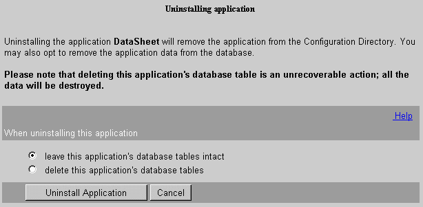

Occasionally, you may have applications that you no longer want to use, and that you want to remove from the end user interface. You can uninstall a closed application, which marks it as Obsolete. Designers can delete obsolete applications from the Process Builder, but they cannot redeploy them. When you uninstall an application, you stop end users from initiating any new process instances from the New Process page.
When you choose the Uninstall command, you are asked if you want to delete the application-specific database tables. If you confirm the deletion, the application's user data is removed. If not, the data is left intact.
You cannot uninstall an application that has any open process instances. You need change the state of any open process instances to terminated if you want to continue with uninstalling the application.
To uninstall a closed application, follow these steps:
  3. For the application you want to uninstall, choose the Uninstall Application command from the drop-down list for that application.
  4. Click Apply.
  5. This displays the Uninstall Application dialog box.
  6. Check the radio button to leave the application's database table intact or to delete it, depending on your situation.
  7. Click Uninstall Application to mark the application as obsolete.
  8. Figure 4.3    The Uninstall Application dialog box
Now you and your end users cannot access the process instance detail for the application. End users cannot initiate new process instances or continue working on existing work items.

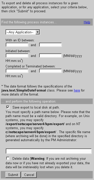

As PAE administrator, you can export or delete application user data that's no longer in use. You can only export and delete data from closed process instances. You cannot delete or export work items separately from the process instances that they are part of.
You can choose to export only, export and then delete, or delete only. You can perform the action for a single application or for all applications at once.
You can access this function through the Export and Delete Data button at the bottom of the main Applications page.
To export or delete user data, follow these steps:
  3. Click the Export and Delete Data button at the bottom of the page below the list of applications.
  4. The following window appears:
    Figure 4.4    The Export and Delete Data page
  5. Select a specific application or "Any Applications" from the drop-down list.
  6. Enter any search criteria.
  7. You search for process instances based on one or more of the following criteria:
  8. Check "Save export to local disk at path" to export the data.

  1. Enter the absolute physical path to the folder in your local file system that you want to use for archiving. If you checked the "Save export..." checkbox, you must enter a path or you get an error when you try to perform the operation.
  2. Check "Delete data" to delete the data. You will lose any data that you haven't exported previously or as part of this operation.
  3. You should export all data before deleting it.
  4. Click Submit to export (and also delete if you checked the delete box) all the application data that meets your criteria.
Note. You can delete data without archiving it, although this is a very risky action to take. This action is not recoverable.
