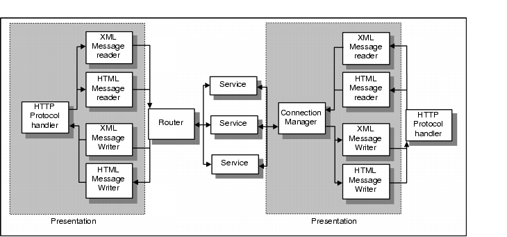

When an iPlanet Trustbase Transaction Manager implementation, on receiving a message, routes the message through to its appropriate service, and the service cannot directly act upon this message, iPlanet Trustbase Transaction Manager utilises the Connection Manager component to process messages appropriately.
Overview
The iPlanet Trustbase Transaction Manager presentation components comprise of a set of protocol handlers, message readers and message writers. The purpose of the protocol handlers is to extract the transport specific headers and footers, determine the MIME type and message type, and to forward the message content to an appropriate message handler.The message handlers are selected on the basis of the MIME and Message type determined by the protocol handlers. The iPlanet Trustbase Transaction Manager provides two default message handlers, these are:
In the case of the Identrus XML message, the appropriate Identrus network processing is performed as described in the following sections.
Figure 2-1    Presentation layer components
In the case of HTML requests, the message reader converts all of the fields in the HTML form into an XML structure represented by a set of DOM nodes.
In both the cases of XML and HTML the output to the router is wrapped with the session information into an iPlanet Trustbase Transaction Manager message. These iPlanet Trustbase Transaction Manager messages are then sent, by the router, to the appropriate service.
The services perform the appropriate message transformation or construction and return an iPlanet Trustbase Transaction Manager message back to the router. The router will then send the iPlanet Trustbase Transaction Manager message back to an appropriate message writer. In the case of the HTML message writer this will extract the DOM values in the message into an HTML template determined by the message type. The template may contain a set of directives that allow conditional or recursive construction of form data.

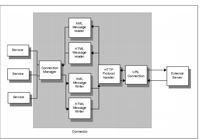

On receiving a message iPlanet Trustbase Transaction Manager routes this message to an appropriate service which can process the message accordingly, and can, if required return a message in response. A problem arises when the particular iPlanet Trustbase Transaction Manager implementation, on receiving a message, routes the message through to its appropriate service, and the service cannot directly act upon this message. It needs additional information from another source in order to complete the task presented to it by the received message. Hence, iPlanet Trustbase Transaction Manager needs the facility to create new messages using specific message transport protocols and send these messages to specific external destinations. To accomplish this, the service needs to call the "Connection Manager".
Figure 2-2    Connection Manager Architecture
Note Please consult your API for more information about this:
The Connection Manager is essentially a service that can be used to send and receive messages to and from external entities. The Connection Manager is passed a iPlanet Trustbase Transaction Manager message and Destination Object. It uses this information to send and receive messages related to the specific message/destination object supplied. The Connection Manager Message Process works as follows:
The Service calls the Connector, passing the iPlanet Trustbase Transaction Manager Message containing the request to the external resource, and a Destination Object describing the external resource. Destination Objects are application-defined implementations, and are recognised by ProtocolMap objects that are application defined plug-in components to the Connector. A null Message parameter may be passed, in which case no attempt will be made to write data to the URLConnection object when a connection has been established.
The Connector calls the ProtocolMapManager to translate the Destination Object it was supplied with into a ProtocolDescriptor Object that specifies a URL for the connections, and a mime-type for the request content. The ProtocolMapManager determines which ProtocolMap from those registered with it (an administration activity ) is responsible for dealing with the supplied Destination implementation, and passes the Destination Object to the ProtocolMap.
The ProtocolMap translates the Destination Object into a ProtocolDescriptor . This action may be simple and local, or it may be complex and involve further external requests.
The Connector makes a connection to the external resource using the URL in the ProtocolDescriptor to form a URLConnection.
If a Message was passed to the Connector, it sets the doOutput variable on the URLConnection to true, to signify it's intention to write data to the connection. The Connector then selects a MessageWriter from its registry of MessageWriters, according to the type of the Message to be written (in the message Type attribute), and the required format, as specified in the ProtocolDescriptor. The MessageWriter is called to translate the Message to the appropriate format, and write it to the OutputStream of the URLConnection. Should no Message have been passed to the Connector, the doOutputfield of the URLConnection is set to false, then nothing is written to the URLConnection..
The Connector hands the InputStream of the URLConnection to the ConnectionProtocolAnalyser, along with the mime-type of the response [determined from the URLConnection]. The ConnectionProtocolAnalyser determines a ProtocolHandler to call, using the mime-type of the response.
The ConnectionProtocolAnalyser gives the selected ProtocolHandler a new iPlanet Trustbase Transaction Manager Message, and the InputStream . The ProtocolHandler reads from the InputStream to determine the Message type of the response, which it sets on the Message (it may also set a Context identifier, although this will be ignored in this setting), before returning.
The Connector selects a MessageReader based on the response Message type, and the response InputStream mime-type. The MessageReader is called to complete the parsing of the response. After the MessageReader completes, the Connector releases any resource used in making the external connection, and returns the parsed Message to the requesting Service.
