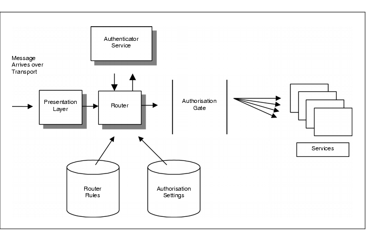

The Router performs the core rule based message routing which is central to the flexibility offered by iPlanet Trustbase Transaction Manager, but it is also responsible for gating access to services on the basis of authentication information and authorisation settings. Figure 3-1 shows the basic elements involved with getting a message through iPlanet Trustbase Transaction Manager and into the service that can process it.
Figure 3-1    Router Architecture
The message arrives at iPlanet Trustbase Transaction Manager and makes its way through the presentation layers (protocol handlers and message readers), during which time the messageType is identified and set and a number of other standard attributes are also set. These attributes form the basis of the authentication evidence for the message.
The stages described above are the basic stages which all iPlanet Trustbase Transaction Manager messages go through. The processing pipeline has been streamlined from the developers point of view when working with Identrus XML messages and is defined in the Default routing section in this chapter.The message then arrives at the router. All messages are initially sent to the service identified by the name "Authenticator". There is a default 'Authenticator' service that comes with iPlanet Trustbase Transaction Manager, but this may be replaced by an alternative implementation if required.
The message is sent to the default Authenticator Service that examines the attributes on the message to assess the authentication level of the message. The function of this service is defined in more detail below.
The message arrives back at the router with a security context attribute (security.role) set, this context attribute determines the Role into which the message has been authenticated.
The target service is located by processing the message through the routing rules and then the message is sent to the service. The detailed definition of these rules is given later on in this section.
Before the message arrives at the service it must pass through an authorisation gate, this authorisation gate checks that there is a mapping between the role attribute assigned to the message and the target service. If such a mapping exists then the message is passed to the service, if no such mapping exists then the message is sent to an authorisation error service.

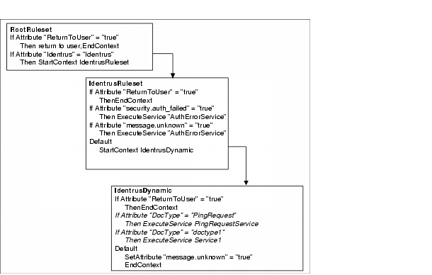

Figure 3-2    Default routing rules

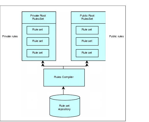

Routing Rulesets
The routing tables have two logical areas, one private and one public. Public rule sets may be added or configured through the management interface, private rule sets are used by iPlanet Trustbase Transaction Manager to provide basic services and may not be configured by the developer or systems administrator. At the top of this structure is the Root Rule Set which governs the way in which the private rules are executed and if none of the private rules match the parameters then the Public Root Rule Set is executed. System developers may then link their own task Rule Sets from this Rule Set (See Rule set definition in the next section)
Figure 3-3    Rule Sets
Each area contains a number of rule sets. Each public rule set will have a name, usually indicating the business task performed by the set of rules. The public rule sets are loaded from disk each time the platform starts up, and may be loaded explicitly by name as the result of a rule execution in the root rule set.
When a message is passed to the router, it will have already been associated with a context. Each context has an association with a rule set. This implies:
The message is operating in its root context, and has the root rule set associated with it.
Rule Sets are processed sequentially, and the first rule to match the current conditions is used. The router takes each rule from the rule set in turn, starting with the first, and attempts to match the message type with a rule pre-condition. If a match is found then the action is executed. If no match is found then an error condition is returned. It is important to bear in mind that because rules are processed sequentially it is necessary to keep the more explicit rules at the beginning of the rule set with more general rules occurring later. Otherwise it is entirely possible that a general rule could preclude other rules from ever being executed.The message is operating in a sub-context, and has a rule set from the public rules area associated with it.
The exception to this is if an iPlanet Trustbase Transaction Manager message is being processed in which case a private rule set will be associated.
It is considered good practice to keep the root rule set as small as possible. To achieve this, a rule in the root rule set should only match the first message in a business task i.e. an unsolicited message. The action should always be to start a new context, indicating the name of a rule set (and potentially the rule name to start at), that the message should be executed in. In doing this, the router will create a new context and associate the named rule set with it. The message will now be processed in the same manner.
