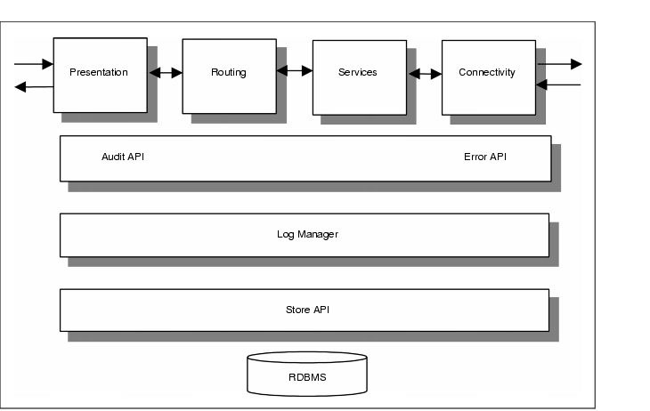

iPlanet Trustbase Transaction Manager provides a set of libraries for use with both error and audit logging. The default implementation of these libraries allow the framework and business components to store information within a relational database for use by external browsers and error management consoles.Both error and audit logs are controlled by a log manager. The log manager stores the data in an appropriate location depending upon its current configuration. This design provides a location independent mechanism for recording error and audit information, and allows components to be re-used between different iPlanet Trustbase Transaction Manager implementations. This log manager is activated each time iPlanet Trustbase Transaction Manager boots. Initially the configuration of the log manager is read from an initialisation file, but in subsequent boot sequences this is read from the persistent configuration object generated by the manager.
Overview
Figure 6-1    iPlanet Trustbase Transaction Manager log manager
The data to be logged by the log manager is supplied by the requesting component in the form of an error or audit log object. The log manager will check the type but not the content of the object being logged. The type checking involved ensures that the object passed is a sub-class of the iPlanet Trustbase Transaction Manager defined error log and audit log classes. This allows the developer to define new error and audit log types for use specifically by the solution e.g. Billing logs.
The Log manager is abstracted from the storage of the data by a Store API. This allows different implementations of a Log e.g. Billing information logs to be stored in different physical repositories, or particular log types e.g. Errors to generate events that are passed to Third Party monitoring systems.

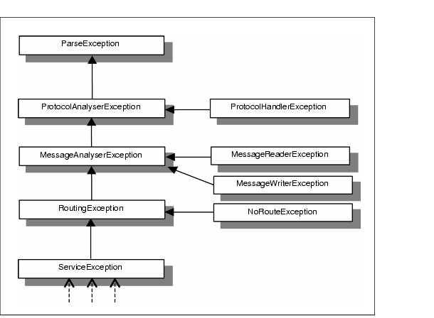

Exception Handling
Exception handling, as with the logging of logical errors, should also log information before the appropriate exception is thrown, in order to enable users and developers of the system to analyse the situation that caused them to arise.The iPlanet Trustbase Transaction Manager exception hierarchy is designed to allow the various components to throw exceptions back to their calling component without the calling component having to explicitly include handling code. This is achieved by having each successive 'level' of exceptions (as related to each successive 'level' of the code) derive from the previous level. For instance consider the example of a service throwing an exception derived from ServiceException. If the service does not explicitly handle the exception it will be passed back to the Router (as the calling component), and because ServiceException is derived from RoutingException we can expect the router to be able to handle the exception gracefully.
Figure 6-2    iPlanet Trustbase Transaction Manager Exception Hierarchy
It is imperative that developers of extension to the system maintain this hierarchical approach to exception inheritance in order that the handling code built into the current iPlanet Trustbase Transaction Manager system will function correctly.
The hierarchical nature of the iPlanet Trustbase Transaction Manager exceptions allows the exception handling to be done differently depending upon where the exception occurs. The components and the associated actions performed are shown in Table 6-5:
