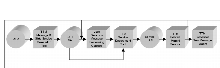

The development of an application requires a base input of an Identrus compliant DTD. This is passed through a class generator that produces Java Classes for all of the elements in the DTD along with a set of stub rules and a service definition within a JAR file. The developer is then at liberty to extend this base data by implementing the appropriate business logic in the form of a set of Java classes called by the service stub that perform the appropriate actions.The set of generated files and associated developer files are then packaged into a single JAR and deployed into an iPlanet Trustbase Transaction Manager directory structure. The iPlanet Trustbase Transaction Manager (when re-started) will locate a package descriptor within the JAR file and offer this new service for activation within the running environment. The overall process is outlined in Figure 8-1.
Figure 8-1    Development process

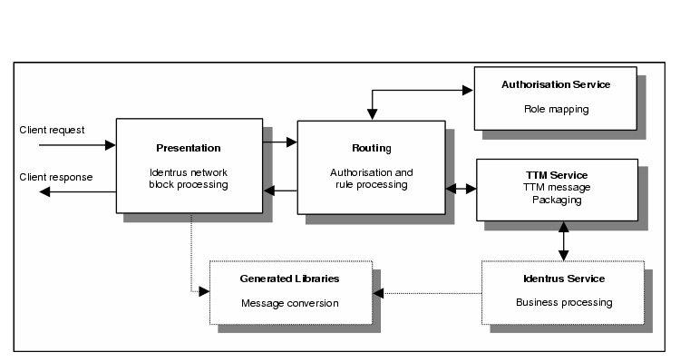

All Identrus network message processing is performed by the iPlanet Trustbase Transaction Manager platform prior to and after the invocation of the ProcessIdentrusMessage method in the service stub class generated by the Class Generation tool. Figure 8-2 shows the message processing path with a Developer written Identrus Service using the generated message libraries and proxied by the iPlanet Trustbase Transaction Manager message process stub.
Figure 8-2    Message path processing
This means that for most Identrus services, the developer only needs to modify the generated stub class to implement the business processing of the incoming message and generate the core content of the outbound message.
