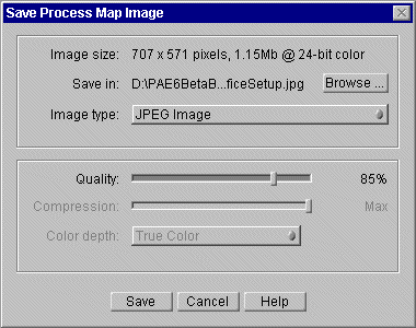

Sometimes you want to export the process mapin other words, save the map outside of Process Builder. For example, by saving the process map as an image, you can later print it or insert it into an HTML document.
To export the process map, open the Application menu and choose "Save Process Map Image."
The "Save Process Map Image" dialog box appears, as shown in Figure 5-1. This dialog box lets you choose what kind of image file to save the process map as.
Figure 5-1    Save Process Map Image Dialog box
To choose where to save the image, select the Browse button, and navigate to the desired folder.
To choose what kind of image file to save the process map as, click the Image Type field, and choose an image type from the menu. The choices are:
- JPEG Image
This encodes and compresses the file and saves it with some lossage (that is, it drops some pixels). This format is great for portability and inclusion in web pages but occasionally you will see color bleeding. This format usually gives the smallest file size.
This option lets you select the quality of the image as a percentage (0 is lowest quality, 100 is highest quality).
- BMP Windows Bitmap
This saves the image as a straight RGB image with no encoding, compression, or lossage. Use this format if you want an exact replica of your process map.
This option allows you to select the color depth of the image.
- PNG Image
This saves the image in the portable network graphics format, which is a compressed, possibly color indexed image, with no lossage. PNG format was designed as a replacement for GIF due to copyright issues with GIF. It generally results in good compression.
This option allows you to select amount of compression and the color depth of the image.

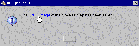

After the process map is saved, a dialog box appears, as shown in Figure 5-2. You can click OK to close this dialog box, or you can click the image link (for example, "JPEG image") to display the new image file that was created.
Figure 5-2    Select the image link to view your saved process map

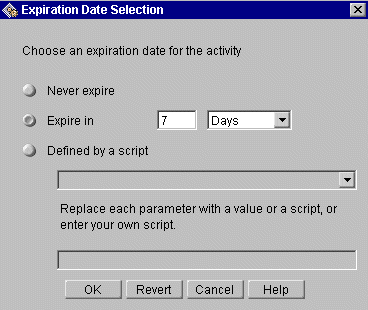

Setting Activity Expirations
When you create a user activity, you can set an expiration date or time for it in the Expiration Date Selection window, either by specifying an expiration or a script to set the expiration.
To set an expiration
- Open the Inspector Window for an activity by double-clicking the activity or highlighting it and clicking the Inspector icon, or right-click and choose Properties.
- From the Expiration Setter Script field, click the right arrow button.
The Expiration Date Selection dialog box appears, as shown in Figure 5-4.
Figure 5-4    The Expiration Date Selection dialog box
- Select the radio button for the type of expiration you want.
- Enter expiration options for the activity.
- Select OK to register your expiration date options and close the dialog box.
The following options are available:
Never expire The activity never expires. This is the default value.
Expire in The activity expires in a specified amount of time. You set the number and a unit of measurement (Months, Weeks, Days, Hours, Minutes).
Defined by a script The script that determines when the activity expires. The product contains no built-in scripts of this type. You can write your own JavaScript scripts, which will then be available in the drop-down list below the Defined by a script radio button.
If you need to set parameters for your script, you define them in the last field in the dialog box. You can give the parameter values, or the names of scripts that return the value. You can also enter your own script here. Enter your own script if you want to use a script that you haven't written yet, or if you want to use a script that is not a expiration setter script (for example, a toolkit script). If you write your own script, it must follow the conventions for expiration setter scripts.
If you set an expiration time or date, you can also set an Expire Manager Script for the activity. An Expire Manager script runs when the activity expires. This script is optional. You must create your own JavaScript script, since none of these scripts are built-in.

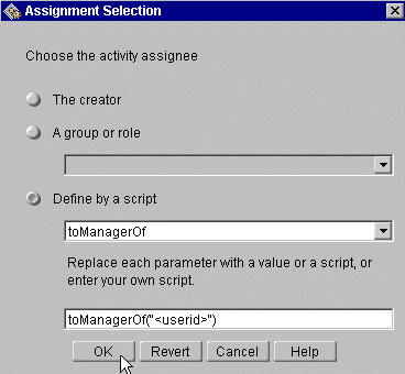

Setting Activity Assignments
You can set a user to be assigned to an activity through an assignment script, many of which are built into Process Builder. You may need to set up some groups and roles before you can assign activities. See Chapter 6 "Defining Groups and Roles" for more information.
To assign an activity
- Right-click the activity in the process map or application tree view and choose "Set assignee script". You can also access the property page and click the Assignment Script field.
The Assignment Selection dialog box appears, as shown in Figure 5-5.
Figure 5-5    The Assignment Selection dialog box
- Select the radio button beside the type of assignment you want.
- Enter any assignment information in the fields.
- Select OK to register your assignment script options and close the dialog box.
There are three ways to specify an assignment:
The creator Assigns this activity to the creator (the person who initiated the process instance).
A group or a role Select one of the roles or groups in the drop-down list. The list contains all the default roles and groups, as well as the ones you've created. If you assign a task to a group, the person in the group who first accepts the work item in Process Express performs the task. The other members of the group do not perform the task. If you want to assign a task to every member of a group for approval, see "Using Parallel Approval".
Defined by a script Assigns this activity using a scripteither a built-in script specified in the drop-down list, or a script whose name you specify in the text field below the radio button.
If you select the "Defined by a script" radio button, you must supply values for parameters contained in angle brackets. For example, using the assignment script toManagerOfRole, you are asked to complete the parameter in toManagerOfRole("<rolename>"). You must replace <rolename> with the field role: for example, toManagerOfRole("product_mgr"). You can also replace parameters with scripts that return the parameter value.
For details on the available assignment scripts you can specify, see "Assignment Scripts".

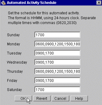

Schedule The schedule for deferred activity. You need to set the Deferred property to true to use this schedule. You set the schedule property in a pop-up dialog box, shown in Figure 5-6.
Figure 5-6    Automated Activity Schedule dialog box
Enter a time into any of the day fields to have the automated activity run at that time on that date. Enter times in the 24-hour clock format (for example, 1300 for 1:00 pm To enter more than one time for a day, separate the times with a comma. If you enter only two digits, Process Builder assumes they are the hour.

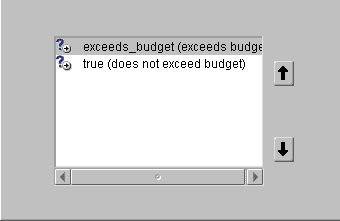

An automated activity also has a Transition Order window, where you can rearrange the possible transitions when there is more than one. You display the Transition Order window by clicking the Transitions tab in the Inspector window.
Transitions out of automated activities always default to true, because a true outcome means the process instance moves on to the transition. When you have more than one transition out of an automated activity, the activity operates in the same way as a decision point, which evaluates multiple conditions (for example, if the price is over $100 or less than or equal to $100) in a specific order. You set the order in the Transition Order window, by clicking the up and down arrows. The top condition in the window is evaluated first. Process Manager uses the first transition condition that is true to route the process instance.

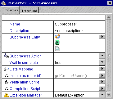

A subprocess is a fully functional process that is called from within another process. The process that calls the subprocess is considered to be the parent process and the subprocess is considered to be its child process. A parent process can have several children processes, each of which is a stand-alone process complete with entry and exit points.
Subprocesses allow process designers to reuse processes across their environment. For example, if a bank has many different loan management processes, all of which require a credit check at a certain point in the process, each of the loan management processes can use the same credit check subprocess. Chapter 16 "The Loan Management and Credit History Applications" describes the Loan Management sample application and its subprocess the Credit History application; the two sample applications show how to use a subprocess in your applications.
Another advantage of subprocesses is that the logic flow of the main process map may be simpler to follow because a certain portion of its processing is hidden behind the subprocess icon. For example, in the Loan Management sample application, the Check Credit History processing is handled in the Credit History subprocess and is not exposed in the main Loan Management process map.
You can use a subprocess in the same way as an automated activity (see "Automated Activities"). You can place it anywhere on the process map, have multiple transitions coming out of it, and place complex scripts within the subprocess to perform actions that are hidden from the main process.
A timer agent coordinates how the parent and child process interact together. The parent process initiates a child process; when the child completes, it sets a value, wf_observer_url, in a Process database table. This is the URL of the parent process. A timer agent periodically checks this database table (by default, every five minutes). If there's a value in the wf_observer_url field, the timer agent attempts to connect the child to the parent process. Once the child successfully connects back to the parent, the value in the database table is set to null so the timer agent does not attempt to reconnect again.
If there's a problem in connecting to the child or to the parent, an exception is thrown and the exception manager allows the administrator to intervene. See "Exception Manager" for more information.

- Open the parent process map.
- Drag a subprocess icon onto the parent process map.
- Right-click the subprocess icon and choose Properties.
The Subprocess Inspector Window appears, as shown in Figure 5-7.
Figure 5-7    The Inspector Window for a subprocess
- Fill in the properties for the subprocess.
- Close the window.
Your changes are saved automatically.
All subprocesses have the following properties:
Name The name of the subprocess.
Description An optional longer description of the subprocess.
Subprocess Entry The entry point in which the parent process enters the child process. To enter the subprocess entry:
- Click the right arrow next to the subprocess icon. The Subprocess Entry Chooser window appears.
- In the list of applications, click the plus (+) sign of the application you want to make a subprocess.
- Choose an action or an entry point and click OK.
Subprocess Action The action that you follow from the Subprocess Entry field.
Data Mapping The data that must be mapped between the child and parent process so that values can be passed easily between them. To define the data mapping:
- Click the right arrow in the Data Mapping field. The Data Mapping Setting window appears.
- In the Mapping Script column, click the arrow for each row. The Field Mapping window appears.
- Enter a static value, select a corresponding field from the parent data dictionary, or define a script and click OK.
- When you have mapped all the data fields, click OK.
Initiator User Id The initiator of the subprocess.
You can use a dynamically derived value as the initiator. For example, in a hiring application that uses a child process to set up a secure ID card for each new hire, you identify a different new employee in each instance of the parent process and you want to use the new user IDs in the child process. In this case, you use a script to pull the new user ID from the corporate directory.
You can use the App User Id of the parent process as the creator of the child process. In this case, you leave the Initiator User Id blank because the default is to use the same user as the creator of the main process.
You can also use a static value as the initiator, which is especially useful when testing. The sample application, for example, uses a static value ("admin") to simplify setting up and deploying the application.
Verification Script The script that runs when the child process is completed. The script must already exist before you can enter it in this property.
Completion Script The script that runs when the child process is completed. The script must already exist before you can enter it in this property. The completion script runs after the verification script.
Exception Manager If an error occurs, the Exception Manager invokes a new work item for correcting the error. Errors can occur in two cases: if a verification or completion script returns false, or if a runtime error occurs in a script (for example, in an assignment, expiration setter, or expiration handler script). See "Exception Manager".

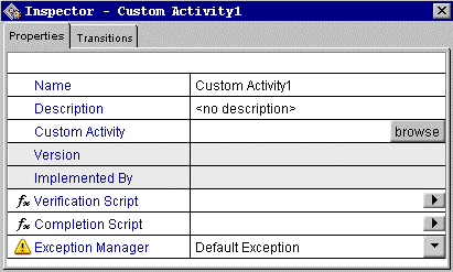

Custom Activity Inspector Window

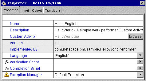

Figure 5-8 shows the Inspector window for a custom activity when you first drag the activity to the process map.
Figure 5-8    Custom Activity Inspector
Note that there are only two tabs in the window: Properties and Transitions. The Properties tab displays the following properties:
Name The name of the custom activity that appears in Process Builder, and in Process Express. Since this name appears on users' work lists, make it descriptive of the action they need to take.
Description An optional longer description of the activity that appears in Process Express.
Custom Activity The file that contains the Java class and its xml descriptor. Use Browse to go to an .xml, .zip, or .jar file to use. After you set this property, the Inspector window changes to reflect information defined by the custom activity you selected.
Version The custom activity's version number.
Implemented By The Java class that implements this custom activity.
Verification Script A script that runs when the step is completed. The script must already exist before you supply it as a property. The verification script runs immediately after the custom activity finishes executing.
Completion Script A script that runs when the step is completed. The script must already exist before you supply it as a property. The completion script runs immediately after the verification script.

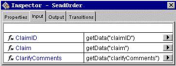

The Input tab shows the parameter names in the custom activity's input hashtable, and shows how the parameter value is derived. Figure 5-10 shows an example of the Input tab.
Figure 5-10    The Input tab
For example, the value for the input parameter claimId comes from getting the value in the application's claimid data field.

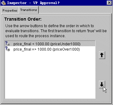

Decision points also have a Transition Order window, where you can rearrange the transitions leading from the decision point. You display the Transition Order window by clicking the Transitions tab at the top of the Inspector window. An example from the DataSheet sample application is shown in Figure 5-15:
Figure 5-15    The decision point Transition Order window
The top item in the window is evaluated first, but you can rearrange items by using the arrow icons. Process Manager uses the first transition condition that is true to route the process instance. So for the example above, the process checks first to see if the price_final field is less than 1000.00. If that is true, the process continues with that transition. If the price_final field is more than 1000.00, the first condition is false, so the second condition is now evaluated. If the second condition is true, the process continues with that transition.

If you have a field with true and false as its valid values, you can use the field name as a transition's condition. An example is shown in Figure 5-16. Suppose you have a field named exceeds_budget, and the value can be true or false. In that case, the first condition is "exceeds_budget," and the second condition is "true."
Figure 5-16    Example of condition set to a field
To make sure these conditions are evaluated in the proper order, open the decision point's Inspector window and click the Transitions tab. This opens the Transition Order window, as shown in Figure 5-17.
Figure 5-17    Example of the Transition Order window for a decision point
The process evaluates the first condition, "exceeds_budget," to see if the value of the field is true or false. If the value of the field is true, then the condition is true, and the process continues with the "exceeds_budget" transition. If the value of the exceeds_budget field is false, the process evaluates the next condition. In this example, the next condition is true. Therefore, its outcome is always true, but it is evaluated last. A final condition of true works like an "else statement." That is, the true condition automatically advances the process if none of the previous conditions are true.
