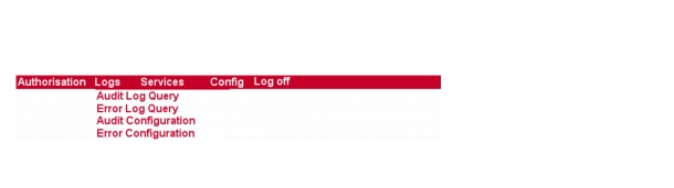

iPlanet Trustbase Transaction Manager allows configuration of three kinds of Logs, two of which are directly viewable:
  • The Audit log contains entries about the flow of a message as it passes through the iPlanet Trustbase Transaction Manager framework (e.g. message handler, Router). This log can be useful in diagnosing problems in configurations.
  • The Error log contains entries of any runtime problems both from the iPlanet Trustbase Transaction Manager framework and the Identrus specific components.
  • The Raw log is only used for Logging Identrus messages both received and sent. This log is not directly viewable.
Figure 5-1    Logs Main Menu

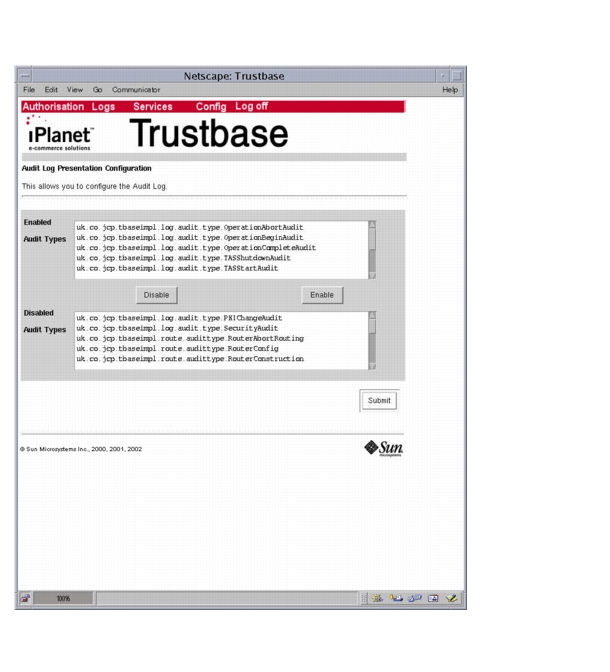

Audit Configuration
Audit Log Configuration allows you to select which audit types are physically viewable. Audit types are either enabled, i.e. they are logged and can be viewed, or disabled, i.e. no information is logged about these types.
In order to configure what gets logged: Select <Audit Configuration> from the main Log Menu.
Figure 5-2    Configure Audit
  • Mouse <Left Click> on the audit type you wish to enable/disable.
  • Select <enable> or <disable>

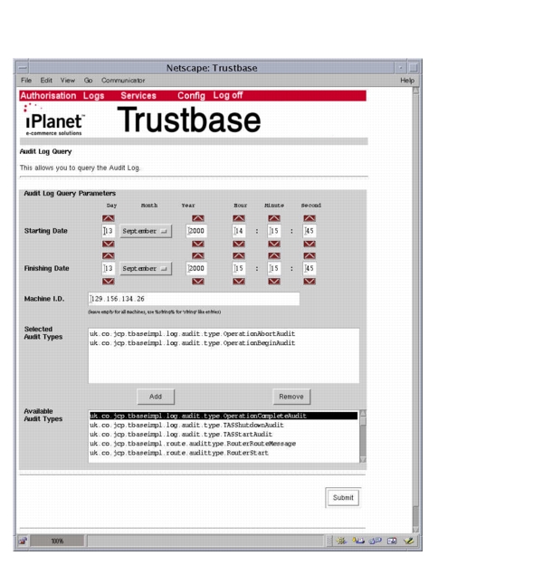

Audit viewing
You can view the audit log by selecting a date range (Start and end date) and machine ID (IP Address). The machine I.D. refers in this case to the machine that is making the log. You can restrict or expand your view by removing or making available the appropriate audit types. Having made your selection the Date, Machine ID, Audit type and message content are displayed on the output screen.
In order to select what you want to view: Select <Audit Log Query> from Main Log menu
Figure 5-3    Audit View
For more detailed log viewing, as all information is stored in a standard Oracle database, any third party database reporting tool may also be used.
The screen, as illustrated in Figure 5-4, might produce an output similar to the following audit:
Figure 5-4    Audit Results
If results do not fit on one page there is an index tab, as illustrated at the bottom of the screen. Users intending to search using SQL should refer to the sql table AUDITDATA.
