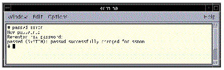

Create a password for each of the new users by typing:
