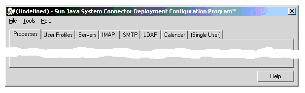

Processes TabThe Processes Tab is shown in Figure 2-2.
Figure 2-2 Deployment Configuration Program: Processes Tab
User mode
These two options, Silent installation vs. Interactive, are mutually exclusive:
Silent: The user program will install and configure the user’s software, and convert the existing default Exchange user profile and existing Personal Folders (.pst) files, without any user involvement whatsoever, according to the administrator’s pre-set parameters for this process (as set in this and the other tabs in this Deployment Configuration Program).
Interactive: The user program will present the user with at least some choices for the installation, configuration and conversion processes. The extent of user involvement will be as determined by the administrator (as set in this and the other tabs in this Deployment Configuration Program).
Processes to include in this configuration
The installation of these software components to user desktops will require access privileges that often are disallowed to many or most end users. If your network serves “locked-down” Windows environments where end users cannot install software, we strongly recommend a “push” method for software distribution from the system administrator to user desktops that bypasses the requirement for user access privileges. This “push” method of distribution is explained in Chapter 3 "“Push” Method Deployment, If End Users Lack Installation Privileges."
For a full explanation of any or all of the processes offered in this panel, and the implications of installing or not installing them, please see “Deployment Toolkit Components” in chapter 1 of the Desktop Deployment Administrator’s Guide.
Install or upgrade Sun Java System. Tells the user program to install the software that facilitates the necessary ongoing communications between the user’s Outlook client application and the Sun Java System server(s). If Sun Java System Connector for Microsoft Outlook is already installed, the user program will check the installed version and, if appropriate, upgrade to the newer version.
The Sun Java System Connector for Microsoft Outlook system requirements include:
- Operating System Windows 2000 or Windows XP.
- Outlook 2000 with Office 2000 Service Pack 3 or higher, or Outlook 2002 with Office XP Service Pack 2 or higher.
- Microsoft Outlook must be designated as the user’s default e-mail client. If Outlook is not set as a user’s default e-mail client, see "To Designate Microsoft Outlook as a User’s Default E-mail Client" in Chapter 3 for instructions to resolve this problem.
- The software cannot be installed to any workstation that also contains the Sun ONE Sync program, which is incompatible with Connector for Microsoft Outlook. If the Sun ONE Sync program has been installed on a particular user’s desktop, it must be removed (see "To Remove the Sun ONE Sync Program from a User’s Workstation", in Chapter 3 for instructions).
The Sun Java System Connector for Microsoft Outlook Setup Wizard will detect any discrepancy between these requirements and the actual installation environment, and in that case will not install Sun Java System Connector for Microsoft Outlook.
Install or upgrade Microsoft Web Publishing Wizard. Tells the user program to install Microsoft’s Web Publishing Wizard (WPW), which makes the user’s Free/Busy information available to the Sun Java System Calendar Server. If WPW is already installed, the user program will check the installed version and, if appropriate, upgrade to the newer version.
<Enter shared path to web kit>. Specify the network location of the installation kit for the Web Publishing Wizard.
Install or upgrade Microsoft LDAP Service. Tells the user program to install the LDAP component of Outlook 2000, which will facilitate communications between Connector for Microsoft Outlook and the Sun Java System directory. If the LDAP component is already installed, the user program will check the installed version and, if appropriate, upgrade to the newer version. This component is required only if some of your users are using Outlook 2000, and is not required if all users are running Outlook 2002. Connector for Microsoft Outlook uses LDAP services to communicate with the Sun Java System directory, and the LDAP protocol is a standard feature of Outlook 2002. The LDAP protocol is only an optional feature in Outlook 2000, not a part of a “standard” Microsoft Office installation. If any of your users are using Outlook 2000 you will need the corresponding original Microsoft installation CD(s) or files to install the LDAP component. These kits are not included in the Desktop Deployment Toolkit package because they are Microsoft products. For more information, see “Deployment Toolkit Components” in the Desktop Deployment Administrator’s Guide.
<Enter shared path to LDAP kit>. Specify the network location of the installation files for the version of Outlook 2000 used by these users.
Create/convert user profile. Activates the User Profiles tabbed panel, so the user program can convert an existing eligible Outlook user profile or create a new profile for use with the new Sun Java System Connector. The user program will convert only an “eligible” profile, meaning that the profile must:
If this box is not marked, the entire User Profiles panel will be grayed out and unavailable, and no user profile will be converted or created. For example, you may want to create a user installation package to simply install or update MAPI services without converting or creating any profiles.
Log file settings
These settings pertain to the directory where the user program will write its log files for the user’s migration session. The first two radio-button options are mutually exclusive:
- Store log files locally: Tells the user program to write its log files to the user’s local “temp” directory.
- Store log files in a shared directory: Tells the user program to write its log files to a particular shared directory:
- <Enter shared folder for Log files>: Specify the shared folder to contain the log files. You can enter a drive letter or a UNC path.
If the Browse feature for Log files does not display the location you need to specify (but you know that it exists): This is an unlikely scenario, but chances are you simply are not authenticated in the domain to which you have browsed. To correct this problem, right-click the target computer and select Explore, and then enter your administrator userID and password at the prompt. You may then return to the Browse feature and select the computer you need to browse.
- Include debug logging: Tells the user program to log its activities in the more verbose, more explicit “debug” style. If a user encounters a problem with the installation package and you can’t diagnose the problem by reviewing the default-style log entries, the more verbose debug-style logging may provide enough additional information to help you or your associates solve the problem. This option is off by default.
Status file settings
Post a one-line status of user activity to a .csv file: Adds a one-line summary of user activity to the .csv file you specify in the accompanying box (below). Each line represents one run of the desktop tool by one user. A single user who runs the tool multiple times should generate multiple lines in the .csv file.
Notes (optional)
Any notes or comments you care to include about this configuration can be added in this field.

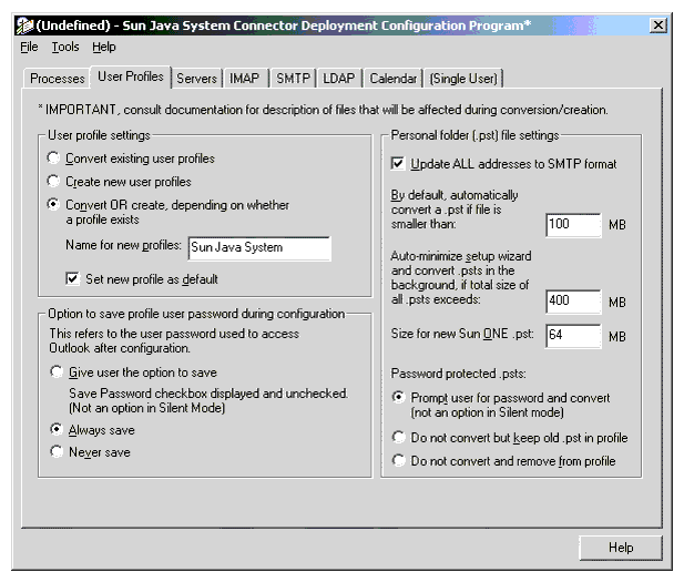

User Profiles TabThe settings in this User Profiles panel, shown in Figure 2-3, apply only if this package will create or convert user profiles. Therefore, the features in this panel are available only if the Create/convert user profile option is checked on the Processes tabbed panel. This entire User Profiles panel will be grayed out if the Create/convert user profile option is unmarked.
The settings in this panel determine how Exchange users’ Contacts, Journal and Notes data will be converted to local (desktop) Sun Java System Connector Personal Folders (.pst) files.
Figure 2-3 Deployment Configuration Program: User Profiles Tab
User profile settings
You may mark options in this section to specify whether and how user profiles will be converted and created:
- Convert existing user profiles: Tells the user program to convert an existing Outlook profile, as follows:
- In Silent Mode: Converts the user’s default profile if it can be found, or does nothing if a default profile cannot be found.
- In Interactive Mode: Prompts the user to select a single profile to convert if it finds two or more eligible profiles connecting to Exchange server(s), or finds only one eligible profile that is not set as the user’s default. If the program finds only one eligible profile, and it is set as the user’s default, the program automatically converts that profile without any user interaction. If the program finds no eligible profiles, it does nothing — neither converts nor creates any user profile.
- Create new user profiles: Tells the user program to create a new Outlook user profile, ignoring any existing profiles that may already exist for the user. It will create only one new profile for a given user, even if the user runs the installation two or more times.
- Convert or Create: Tells the user program to convert an existing Outlook user profile if it can find one, or create a new profile if it cannot find an existing one:
- In Silent Mode: Converts the user’s default Outlook profile if it can be found, or creates a new profile if a default profile cannot be found.
- In Interactive Mode: Prompts the user to select a single profile to convert if it finds two or more eligible profiles connecting to Exchange server(s), or finds only one eligible profile that is not set as the user’s default. If the program finds only one eligible profile, and it is set as the user’s default, the program automatically converts that profile without any user interaction. If the program finds no eligible profiles, it creates a new one.
- Name for new profiles: The name by which the new profile will be identified in the drop-down list box that appears on Outlook’s user logon screen.
- Set new profile as default: If this box is checked, the new profile will be set as the user’s default Outlook profile.
Save password options
- Give user the option to save: Tells the user program to display a checkbox that lets the user choose whether Outlook should prompt the user for a password upon each login, or save (“remember”) the password so the user can skip that login step. Within the user program, the instructions displayed with the checkbox explain: “If checked, you will not need to enter your information each time you launch Outlook.” This option is not available if this package is configured to run in Silent mode.
- Always save: Tells the user program to not offer the user the choice described above (for Give user the option...). Instead, the screen will display this message: “Your password will be saved. You will not need to enter your password each time you launch Outlook.”
- Never save: Tells the user program to not offer the password choice, so Outlook will always prompt for user passwords, by default. The user program will display no checkbox or related explanatory text.
Personal folder (.pst) file settings
Update ALL addresses to SMTP format: Tells the user program to convert all addresses that occur within Personal Folders (.pst) files to SMTP (Internet standard) format.
By default, automatically convert a .pst if file is smaller than: ____ MB: In Silent mode: The user program will ignore (not convert) any .pst files larger than or equal to the size specified here. In Interactive mode: If any existing .pst files are larger than or equal to the specified size, the program will prompt the user to specify which (if any) of the large files to convert.
Auto-minimize setup wizard and convert .psts in the background, if total size of all .psts exceeds: ____ MB: This setting is irrelevant in Silent mode. In the Interactive mode, if the total size of all .pst files to be converted exceeds the size specified here, the user program will convert the profiles first, and then automatically minimize itself to the user’s Task Bar to convert the .pst files as a background process. Once the profile has been converted, the user can run Outlook and access the converted profile.
Size for new Sun Java System .pst: ____ MB: The expected amount of disk space required for the new .pst file into which selected items from the old Exchange server are copied. The user program aborts the conversion if a user does not have this much disk space available. Leave this value set at its default unless you have some particular reason to expect that your .psts will be larger.
Password protected .psts: Choose one of these mutually exclusive options for converting password protected .pst files:
- Prompt user for password and convert (not an option in Silent mode): Tells the user program to prompt the user for the password to open each .pst file and convert it.
- Do not convert but keep old .pst in profile: Tells the user program to not convert the .pst file, but to keep the unconverted .pst file in the profile.
- Do not convert and remove from profile: Tells the user program to not convert the .pst file, and to remove the unconverted .pst file from the profile. (The old .pst file is not, however, physically deleted from the user’s hard drive.)

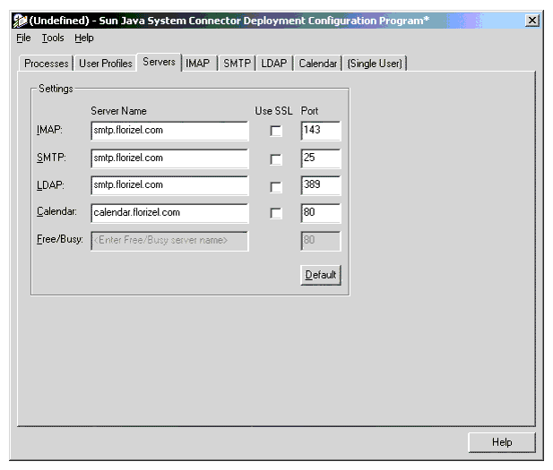

Servers TabThe Servers tab is shown in Figure 2-4.
Figure 2-4 Deployment Configuration Program: Servers Tab
Settings
Server Name: The host name for each Sun Java System server: IMAP, SMTP, LDAP, Calendar, and Free/Busy.
Use SSL: Mark this box to require an SSL to connect to the associated server.
Port: The default port number for each server. The default changes if you use SSL to connect to the server.
Default: Restores all Port numbers back to their original default values (if you have changed the values but now want to restore the defaults). The default values for SSL vs. non-SSL are different, and this feature will restore the appropriate default for any given server depending on whether the Use SSL box is marked.

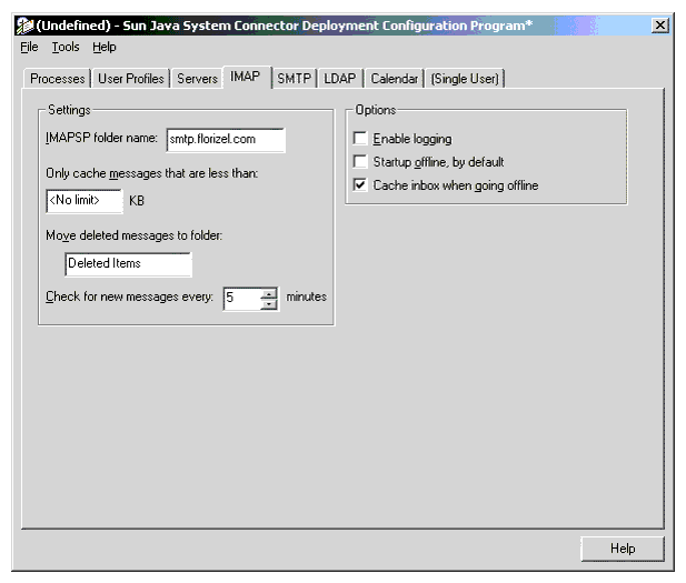

IMAP TabThe IMAP Tab is shown in Figure 2-5.
Figure 2-5 Deployment Configuration Program: IMAP Tab
Settings
IMAPSP folder name: The name that will appear next to the IMAPSP Folders icon in the Outlook Folder List. If left unspecified, the Server Name field (from the Servers tabbed panel in this same Deployment Configuration Program) will appear as the folder name instead.
Only cache messages that are less than: ____ KB: The per-message size limit for the IMAPSP local message cache. This option is intended primarily to reduce download times when the user goes into offline operations. This value, however, will also affect re-display times in online mode, because the message will need to be re-retrieved if it has not been cached.
Move deleted messages to folder: The name of the folder for IMAP trash, where you want deleted messages to be moved.
Check for new messages every: ___ minutes: This is the interval, in minutes, after which a server mailbox will be polled for newly arrived messages. If any new messages have arrived, the mailbox is refreshed and redisplayed in Outlook. If this field is cleared or set to zero, no polling will be done for this server connection.
Options
Enable logging: Causes log, error, and trace information to be sent to a file named ISTOREx.LOG (where 'x' is a numerical value for the day of week, 1-7) in the PC's temp(orary) directory. Only the last three days' logs are saved.
Startup offline, by default: Configures IMAPSP to not initially attempt a connection to the server, so the user will have to execute the Online mode menu to go online.
Cache inbox when going offline: Configures IMAPSP to cache the Inbox when the user goes offline. Alternatively, the user can set the caching status of a given mailbox by highlighting the folder entry in Outlook, then executing the Properties menu, pressing the IMAPSP tab, and turning on the Cache all message parts (attachments) for this folder option.

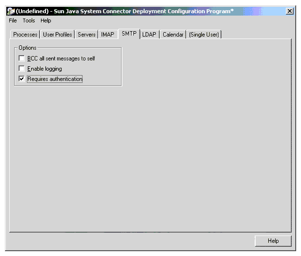

SMTP TabThe SMTP tab is shown in Figure 2-6.
Figure 2-6 Deployment Configuration Program: SMTP Tab
Options
BCC all sent messages to self: Configures the user software to automatically insert the user’s e-mail address into the BCC field of every outbound message (effectively lets a sender file a copy of every message sent). The messages are filed within a sender's server INBOX, and subsequently will be affected by any server-based message filtering rules.
Enable logging: Causes log, error, and trace information to be sent to a file named ISSMTPx.LOG (where 'x' is a numerical value for the day of week, 1-7) in the PC's temp(orary) directory. Only the last three days' logs are saved.
Requires authentication: Tells the user software to configure the SMTP Service so as to require user authentication for outbound SMTP mail.

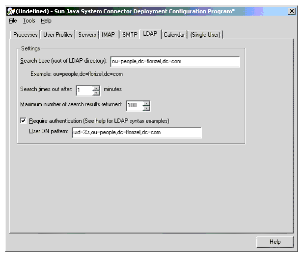

LDAP TabThis LDAP tabbed panel, shown in Figure 2-7, lets you specify the settings for the Outlook LDAP Directory Service.
Figure 2-7 Deployment Configuration Program: LDAP Tab
Settings
Search base: The LDAP distinguished name of the root of your LDAP directory. For example, if the top level of your directory is o=florizel.com and your address book in the organizational unit is named ou=People, then your search base should be set as ou=People,o=florizel.com.
Search times out after: ___ minutes: Limits directory search times to the designated number of minutes.
Maximum number of search results returned: Limits the number of entries returned by a search to the number specified here.
Require authentication: Tells the user software to configure the LDAP Directory Service so as to require user authentication in the form of a user Distinguished Name (DN) for each directory query.
- User DN pattern: The elements of the user’s Distinguished Name (DN) that, when assembled, will form the complete DN to authenticate the user’s identity to the LDAP Directory Service (if authentication is required). For example, to define a DN consisting of a user ID (uid), an organization unit (ou) and an organization (o): uid=%S,ou=people,o=florizel.com

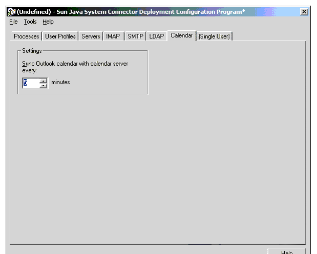

Calendar TabThe Calendar tab is shown in Figure 2-8.
Figure 2-8 Deployment Configuration Program: Calendar Tab
Settings
Sync Outlook calendar with calendar server every: ___ minutes: Specifies how often the Outlook calendar will synchronize with the calendar server.

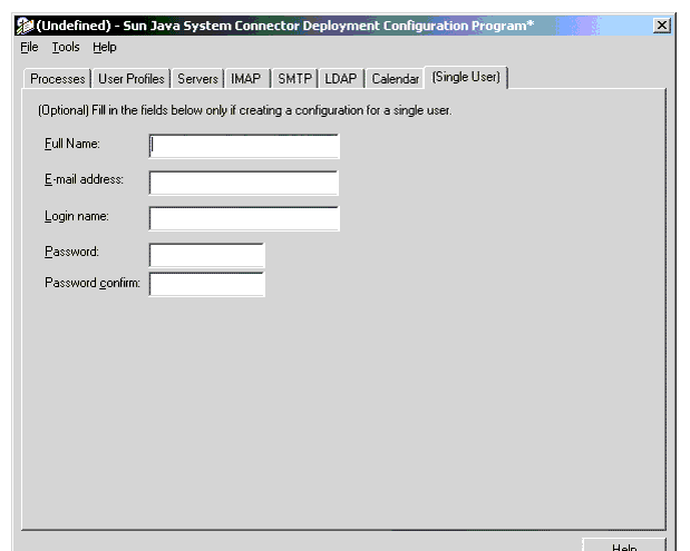

Single User TabThe Single User tabbed panel, shown in Figure 2-9, lets you specify and authenticate the identity of a single specific user. This panel applies only if you are creating an installation kit for one particular user.
Figure 2-9 Deployment Configuration Program: Single User Tab
Settings
Full name: The “friendly” name associated with the user's e-mail address. When sending messages, this name appears in the From box of the user's outgoing messages.
E-mail address: Specifies the e-mail address that people should use when sending mail to the user at this account — must be in the format name@florizel.com.
Login name: Specifies the user's account name, which must be the same value for both the IMAP and calendar servers. This is often the same as the part of the user's e-mail address to the left of the “at” sign (@).
Password: The user's account password, which must be a single shared password used for both the IMAP and calendar servers.
Password confirm: A duplicate field for the user’s account password, required as a precaution against typographical errors. (This value must match the Password value above.)
