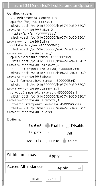

To reach the following dialog box, right-click on the test name in the System Map and select Test Parameter Options. If you do not see this test in the System Map, you might need to expand the collapsed groups, or your system might not include the device appropriate to this test. Refer to the SunVTS User's Guide for more details.
FIGURE 17-1 env3test Test Parameter Options Dialog Box
TABLE 17-1 env3test Options
Option
Description
Fan Test
Displays the percentage of performance at which each fan is running. The temperature values are in degrees Celsius.
Target
Specifies the target devices.
Log File
Logs two lines of information read from the system into the log file /var/opt/SUNWvts/logs/env3test.log. The first line is a time stamp. The second line is a list of names and the read values, for example,Wed May 24 13:55:57 2000system-fan , 19, cpu-fan , 49, power-supply-fan , 100, cpu , 81, cpu-ambient ,24
