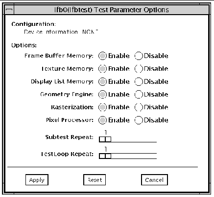

To reach the following dialog box, right-click on the test name in the System Map and select Test Parameter Options. If you do not see this test in the System Map, you might need to expand the collapsed groups, or your system might not include the device appropriate to this test. Refer to the SunVTS User's Guide for more details.
By default, all ifbtest options are enabled.
FIGURE 27-1 ifbtest Test Parameter Options Dialog Box
