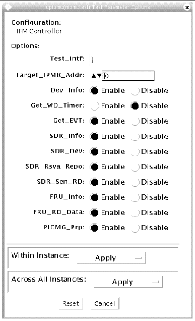

To reach the following dialog box, right-click on the test name in the System Map and select Test Parameter Options. If you do not see this test in the System Map, you might need to expand the collapsed groups, or your system might not include the device appropriate to this test. Refer to the SunVTS User's Guide for more details.
FIGURE 42-1 nipmc test Test Parameter Options Dialog Box
TABLE 42-1 nipmctest Options
Option
Description
Test_Intf
Specifies Open or ipmb interface.
Target_IPMB_Addr
Specifies the ipmb interface address of the target (response) device rsAddr. 0 is for local IPMC and is default.
Dev_Info
Enables or disables the device ID command.
Get_WD_Timer
Enables or disables the watchdog timer command. Has no effect when enabled.
Get_EVT
Enables or disables the event receiver command.
SDR_Info
Enables or disables the device SDR information.
SDR_Dev
Enables or disables the device SDR command.
SDR_Rsva_Repo
Enables or disables the device SDR repolitory command.
SDR_Sen_RD
Enables or disables the sensor reading command.
FRU_Info
Enables or disables the FRU inventory area information command.
FRU_RD_Data
Enables or disables the FRU data command.
PICMG_Prp
Enables or disables the OEM specific command (command: 0, 5, 6, 8, 0xb, 0xd, 0xe, 0x12, 0x14, 0x16).
