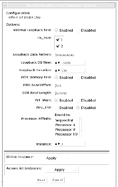

ibhcatest Options
To reach the following dialog box, right-click on the test name in the System Map and select Test Parameter Options. Because graphics tests can test multiple types of frame buffers, the test name that is displayed corresponds to the particular frame buffer being tested. See Testing Frame Buffers. If you do not see this test in the System Map, you might need to expand the collapsed groups, or your system might not include the device appropriate to this test. Refer to the SunVTS User's Guide.
FIGURE 10-1 ibhcatest Test Parameter Options Dialog Box
