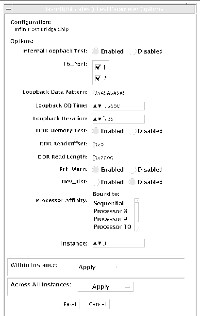

ibhcatest Options
To reach the following dialog box, right-click on the test name in the System Map and select Test Parameter Options. Because graphics tests can test multiple types of frame buffers, the test name that is displayed corresponds to the particular frame buffer being tested. See Frame Buffer Tests. If you do not see this test in the System Map, you might need to expand the collapsed groups, or your system might not include the device appropriate to this test. Refer to the SunVTS User's Guide.
FIGURE 26-1 ibhcatest Test Parameter Options Dialog Box
TABLE 26-2 ibhcatest Options
Option
Description
lb=Enabled|Disabled
Turns the loopback test on or off.
tlbport=1+2
Loopback test on Port 1 and/or 2, default is 1+2.
data=Pattern
Specific data pattern (default patterns 0xa5a5a5a5).
cq=Time
Number of CQ polling time value (in microseconds per iteration). The default is 55000. The maximum is 1000000.
loop=Number
Number of loopback iterations for each pass. The default is 200. The maximum is 1000.
ddr=Enabled|Disabled
Turns the DDR memory test on or off.
rdoffset=Offset
Starts the offset of DDR memory read. The default is 0x0 in hexadecimal.
rdsz=Size
Read number of byte of DDR memory from Offset to Max address location. The default is 0x2000. The maximum is 256 MB in hexadecimal
warn=Enabled|Disabled
Prints a warning message when enabled.
list
Prints device list. No testing occurs when set.
