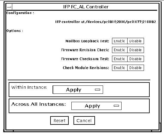

To reach the following dialog box, right-click on the test name in the System Map and select Test Parameter Options. If you do not see this test in the System Map, you might need to expand the collapsed groups, or your system might not include the device appropriate to this test. Refer to the SunVTS User's Guide for more details.
FIGURE 28-1 ifptest Test Parameter Options Dialog Box
TABLE 28-2 ifptest Options
ifptestOptions
Description
Mailbox Loopback Test
Enables or disables the mailbox loopback command. This test writes data patterns into the mailboxes and then reads them
back from the output mailboxes and verifies the data is correct.
FirmwaRe Revision Check
Enables or disables the firmware revision check command. This test extracts the firmware revision from the RISC firmware code and verifies against expected values.
FirmwarE Checksum Test
Enables or disables the firmware checksum command.
This command instructs the interface's RISC processor to calculate the checksum on the current microcode and then compare it against the checksum that was loaded in with the microcode.
Check Module Revisions
Enables or disables the firmware check module command. This command returns the revision level of several submodules on the interface card. Although this test is executed when enabled, the module revision levels are only printed out in VERBOSE mode.
