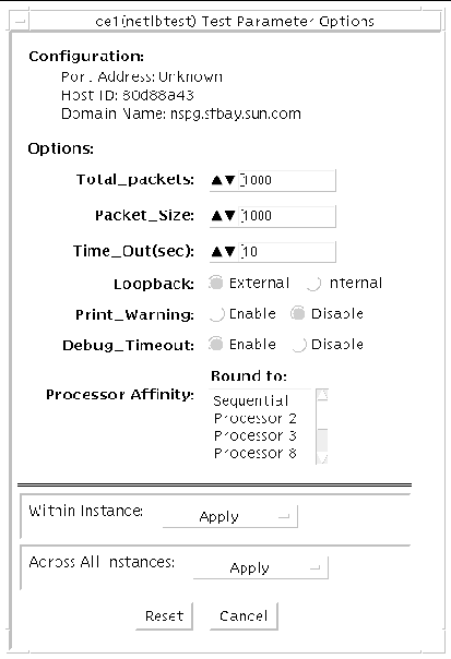

To reach the following dialog box, right-click on the test name in the System Map and select Test Parameter Options. If you do not see this test in the System Map, you might need to expand the collapsed groups, or your system might not include the device appropriate to this test. Refer to the SunVTS User's Guide for more details.
Refer to TABLE 13-1 for test parameter descriptions.
Runs the full set of subtests. The host must not be connected to the network through the intended test device. |
Since netlbtest requires a loopback connector for the external loopback test, it can only be selected when Intervention mode is enabled.
