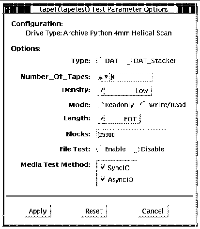

tapetest supports 4-mm, 8-mm, DLT, 1/4-inch cartridge, and 1/2-inch front-load tape drive testing. The options available for each of the tape devices differ slightly. An example of the Test Parameter Options dialog box for a device is shown in FIGURE 20-1.
FIGURE 20-1 tapetest Test Parameter Options Dialog Box
Note - This test does not immediately stop after being disabled.
Note - Selecting nondefault options can significantly increase the run time for the test.
Note - The Test Parameter Options dialog box for the 1/4-inch, 1/2-inch, DLT, and 8-mm tape drives differ slightly from FIGURE 20-1.
TABLE 20-1 tapetest Options
tapetest Options
Description
Type
Normal tape drive or tape library (stacker).
Number of Tapes
The number of tapes in the tape library. tapetest registers a single tape library pass only after all tapes in the library pass.
Density
The following settings are available for most tape drives:
- Low - Tests the l tape device.
- Medium - Tests the m tape device.
- Compression - Tests the c tape device.
- All - Tests the l, m, and c tape devices.
For half-inch tape drives, the available settings are 800, 1600, and 6250 BPI (blocks per inch).
For certain QIC drives, select QIC-11 (1-byte block ID) mode, QIC-24 (4-byte block ID) mode, or Both.
Note: On a DLT drive, the l and m settings both use no compression. tapetest does not support changing DLT capacity settings indicated on the front panel.
Mode
If you enable Write/Read mode, the test first writes to the tape and then reads it back to compare. If you enable Read_Only mode, the test assumes the tape has been properly written and merely reads and compares. This mode is useful to check proper head alignment.
Note: If a read only pass is attempted and the tape was not previously written by tapetest, using the same test parameters currently set, a Big Read Failure will occur.
Length
The amount of the tape to be tested. The choices are:
- EOT - The default; tests to the entire tape.
- Long - The SCSI tape tests 70,000 blocks of the tape.
- Short - Only the first 1000 blocks are tested.
- Specified - You must type the number of blocks to be tested in the blocks field.
# of Blocks
If you select Specified under the Length option, you must type the number of blocks you want to test.
Blocksize
Block size specification. This option is only available for Tandberg QIC tape drives. There are two possible values. 512-bytes is for use with older tape media that have transfer size restrictions, while 64-kbytes is for use with current, high-capacity tape media.
Note - This option is only available in command line interface mode.
Note - With patches 110278-01 or 110211-01 applied, DLT writes either a 512 byte or 65536 byte block depending on how this parameter is set.
File Test
The tape file test sequence is as follows:
- Writes three files.
- Rewinds.
- Reads part of the first file.
- Forward spaces to the start of the second file.
- Reads the second file.
- Forward spaces to the start of the third file.
- Tries to read to the end of that file for SCSI tapes only. The tape file test tries to backspace to the start of the second file and read it.
Retension
When enable is selected, the program retensions the tape.
Media Test Method
- Sync I/O--tapetest reads and or writes the number of blocks selected in Length.
- Async I/O--tapetest makes four asynchronous read requests to the tape drive. If read and write testing is selected, one asynchronous write request is also sent. The test continues after completing the requests.
Note - When testing Tandberg QIC drives, Async I/O testing is restricted to read-only due to asynchronous behavior differences with other tape drives.
Note - This option is not associated with the synchronous data transfer request SCSI message. It is only synchronous or asynchronous in nature because the numbers of reads and writes are not synchronous to each other. The SDTR message is not invoked.
