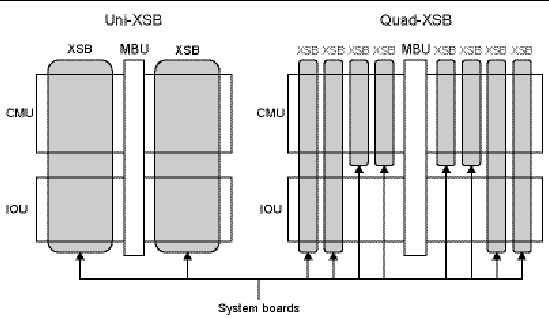

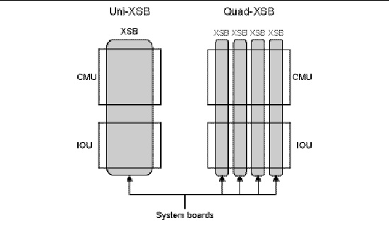

SPARC Enterprise M4000/M5000/M8000/M9000 servers have a unique partitioning feature that can divide one physical system board (PSB) into one logical board (undivided status) or four logical boards. A PSB that is logically divided into one board (undivided status) is called a Uni-XSB, whereas a PSB that is logically divided into four boards is called a Quad-XSB. Each composition of physical unit of the divided PSB is called an eXtended System Board (XSB). These XSBs can be combined freely to create domains.
DR functions on these servers are performed on an XSB. This manual uses the term system board unless physical units of PSB and XSB are described. For an explanation of each term, see TABLE 1-2.
FIGURE 1-1 Uni-XSB and Quad-XSB (Midrange Servers)
FIGURE 1-2 Uni-XSB and Quad-XSB (High-end Servers)

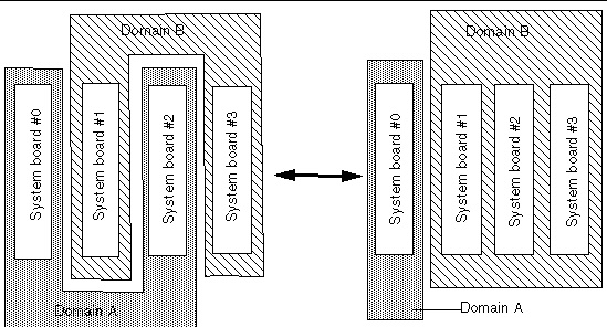

FIGURE 1-3 shows DR processing.
In the example shown in FIGURE 1-3, system board #2 is deleted from domain A and added to domain B. In this way, the physical configuration of the hardware (mounting locations) is not changed but the logical configuration is changed for management of the system boards.
