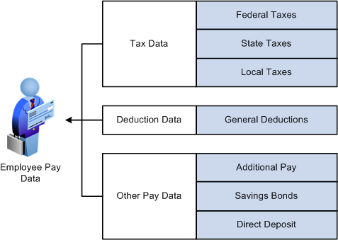

This diagram illustrates the types of payroll data that you may need to maintain:
Maintaining payroll data
