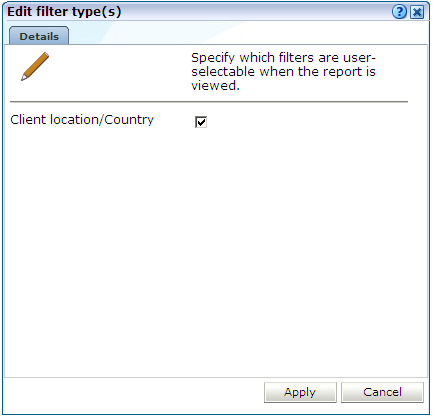

3.7.3 Using Report Filters
Report filters can be used with reports that you create from the Data Browser. When you specify a report filter for information you include in a report, the user opening the report can use the defined filter when viewing the report's contents.
For example, if you are viewing client location information (via the All sessions groups, and the client-location sub-group), you could create a report that allowed its users to select on client location. To define the filter, do the following:
  1. Select a value from the displayed list of locations, and define it as a filter.

  4. Highlight the filter by placing the mouse pointer over it, and select Edit filter type from the menu. A dialog similar to the one shown in Figure 3-15 appears.
    Figure 3-15 Edit Filter Type(s) Dialog
    Description of Figure 3-15 follows
    Description of "Figure 3-15 Edit Filter Type(s) Dialog"
  5. Use the check box(s) shown in the Edit filter type(s) dialog to control which filters can be selected by a user when the report is opened. There will be a check box for each defined report filter. When ready, click Apply.
  6. Save the report, as described in Section 2.9, "Creating New Reports".
