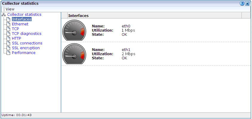

You can view the status of each Collector attached to the system by selecting System, then Status, and then Collector status. It opens the Network data Collectors window. An example is shown in Figure 9-2.
The System (localhost) refers to the Collector instance on the Reporter system. Other Collectors within the network are represented by their IP address. For each Collector, the following menu options are available:
View statistics: displays a detailed report of the traffic monitored by the Collector. An example is shown in Figure 9-3. This is described in more detail in the following section.
Configure: opens a sub-menu through which you can configure security-related settings for the selected Collector. These are described in Chapter 8, "Managing Security-Related Information."
Edit description: allows you to modify the brief description specified when the Collector was registered (see Section 9.2.2, "Attaching New Collectors"). This can be useful for providing additional information about the Collector system. For example, where the Collector is patched in the organization's network, or the contact information for the system's administrator.
Restart: restarts the selected Collector. You are prompted to confirm the restart.
Unregister: removes an attached Collector from the Reporter system. You are prompted to confirm the Collector's removal.
The information shown in this window (Figure 9-3) refers to the traffic monitored since midnight for the selected Collector, or the counters were reset. The Uptime field in the bottom left-hand corner of the window shows the time the Collector has been running. The uptime is reset when the Collector is restarted to update its configuration. You can reset all HTTP request counters shown in the window by selecting Reset counters from the View menu. Note that the counters will be reset the next time a network packet is detected. Hence, on an installation with no network traffic, the counters will never be reset. The display is automatically refreshed every two seconds.
The tabs available in the top-left part of the part of the window provide a detailed breakdown of the traffic monitored by the selected Collector. They are explained in Table 9-2.

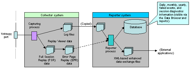

The availability of specific data within the Data Browser, as well as reports based on that data, depends on the amount of available disk space on the Collector and Reporter systems, as well as the amount of database space available on the Reporter system. This is illustrated in Figure 9-10.
Figure 9-10 Data Retention Across Collector and Reporter Systems

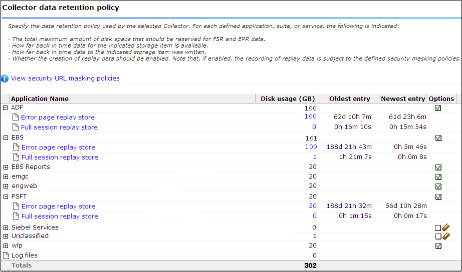

Data gathered during monitoring is first written to log files, stored on the Collector system. These files are copied to, and processed by, the Reporter to populate the database that holds the multi-dimensional data structure viewable through the Data Browser and reports. These temporary log files are automatically removed from the Collector system after three days, and from the Reporter system (by default) after seven days. Note that data masking options (described in Section 8.4, "Masking User Information") can be specified to omit the logging of sensitive information.
The log files are used to created the Full session replay (FSR) data store. These files are regularly filtered to create the Error page replay (EPR) data store. The EPR files only contain information about failed events (that is, failed pages, objects, and function calls). Both the FSR and EPR data is held on the Collector system.
The size of the database user quota for the Reporter system is configurable during installation. By default, it is set to 200 GB. It is important to understand that data is consolidated when it is no longer required by the Reporter's defined retention policy. For example, by default, daily information about the last 32 days is retained. Daily information older than this is consolidated into the monthly information. Similarly, monthly information is consolidated into yearly information. Finally, if the enhanced data exchange facility has been enabled (see Section 9.20, "Exporting Enriched Data"), an export file is created every five minutes. The XML-based export files are, by default, retained for seven days.
By default, RUEI keeps information on a daily, monthly, and yearly levels for 32 days, 13 months, and five years, respectively. Hence, for example, the oldest daily information will be dropped after 32 days. In addition, temporary log files are kept on the file system for approximately seven days. Be aware that a new RUEI installation will grow quickest during the first 32 days. After that time, the growth rate will slow. Of course, the growth rate depends on monitored traffic levels.
By default, information about failed URLs, pages, and service calls is kept for 15 days. If available, it can be viewed via the Session diagnostics replay facility (described in Section 3.10, "Working With the Diagnostics Facility").

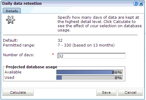

Daily data retention: specifies the period for which daily information is available. The default is the last 32 days. The maximum period for which daily data may be kept depends on the monthly setting.
Monthly data retention: specifies the period for which monthly information is available. The default is the last 13 months. The maximum period for which monthly data may be kept depends on the yearly setting.
Yearly data retention: specifies the period for which yearly information is available. The default is the last five years. The minimum setting depends on the daily setting, while the minimum number depends on the monthly setting.
Maximum data group size: specifies the maximum size to which data groups are permitted to grow. This setting is fully described in Section 9.6.2, "Setting the Maximum Data Group Size".
A dialog similar to the one shown in Figure 9-12 appears.
Use the dialog's control to specify the retention policy for the selected option.
For most settings, you can click Calculate to see the effect of your selection on database or disk space usage, as applicable.
When ready, click Save. Note that changes to disk space allocations take effect after approximately 10 minutes, while changes to database allocations only take effect after midnight.

To specify the data retention policy used by a Collector system, do the following:
Select Configuration, then General, then Advanced settings, and then Collector data retention policy. The panel shown in Figure 9-13 appears.
Figure 9-13 Collector Data Retention Policy
Use the View menu to select the required Collector. The System (localhost) represents the Collector running on the Reporter system.
For each currently defined application, suite, or service, the Oldest data column indicates how far back in time (in seconds, hours, minutes, or days) data for the indicated storage item is available. Typically, if the oldest entry is reported as 10 minutes, this indicates a very busy system that cannot store more than 10 minutes of data. The Newest entry column indicates how far back in time data to the indicated storage item was written.
The Log files item indicates the amount of disk space used on the Collector for the storage of temporary log files. Note that in the case of a local Collector, this will always be zero.
For each application, suite, or service, use the check box in the Options column to specify whether the creation of replay data should be enabled. By default, replay data is enabled. You are prompted to confirm any change you make. In addition, you are prompted to restart the Collector.
Click either the Error page replay store or Full session replay storage option for the application you want to modify. A dialog similar to the one shown in Figure 9-14 appears.
Figure 9-14 Error Page Replay Store Size Dialog
Specify the maximum amount of disk space that should be reserved for FSR or EPR data on the selected Collector for the specified application, suite, or service.
Note that the storage items for the "Unclassified" application refer to the maximum amount of disk space that should be reserved for network traffic that could not be associated with a particular application, suite, or service.

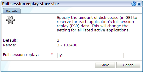

Alternatively, Instead of specifying the FSR and EPR data store sizes for individual applications, suites, and services, you can click the Set Full session replay store size for all applications or Set Error page replay store size for all applications icon. A dialog similar to the one shown in Figure 9-16 appears.
Figure 9-16 Full Session Replay Store Size Dialog
Specify the maximum amount of disk space for FSR or EPR data reserved on the selected Collector system for each application, suite, or service. When ready, click Save.
You are prompted to restart the Collector. This is necessary in order to make your changes effective. Note that you can also restart the selected Collector by clicking the Restart Collector icon shown in Figure 9-13.

You can open an overview of the monitored network traffic by selecting System, then Status, and then Data processing. This provides you with immediate information about hits, pages, and session processing, as well as the system load. An example is shown in Figure 9-17.
Note the Available resource usage (%) item on the Performance tab indicates the current processing level. If this approaches 100%, it means a lag in the processing of data is starting to occur, and it is no longer possible to process data in real time.
Be aware that because this facility is based on application logic, non-application traffic (such as suites, services, and SSOs), are not represented in the displayed reports.

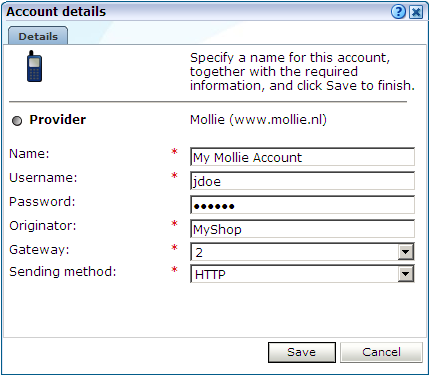

RUEI supports the use of text message notifications. In order to make use of this facility, all text message providers that you are planning to use must be configured and known to the system. To manage your provider information, select System, then Maintenance, and then Text message providers. The dialog shown in Figure 9-21 appears.
To configure a text message provider, do the following:
Click « Add new account » to define a new text message provider. The dialog shown in Figure 9-22 appears.
Figure 9-22 Select Text Message Provider Dialog
Select the required text message provider from the list. It contains a number of predefined supported services. Each of these require an account with the associated provider. When ready, click Next. A dialog similar to the one shown in Figure 9-23 appears.
Important:
If you specify a local GSM modem, a GSM modem must be installed on the system. The installed local modem must be a USB or serial GSM ETSI 07.05-compliant modem.The exact fields available within the dialog depend on the provider selected in Figure 9-22. For example, if you selected a local GSM modem, you are required to specify the local port and baud rate for the modem. If not known, automatic detection is available. Optionally, you can also specify a SIM PIN (if one is required).
If you selected the predefined Mollie or Clickatell services, you are required to specify the user name, password, originator, API ID, and protocol sending method used for the account. These should have been supplied to you by your account provider. When ready, click Save. You returned to the dialog box shown in Figure 9-21.
Right click the providers in the list and use the Move up and Move down options to control a provider's position in the list. Providers are tried in the order they appear in the list. Hence, the first account is tried and, on failure, the second one, and so on.
When ready, click Close to leave the dialog.

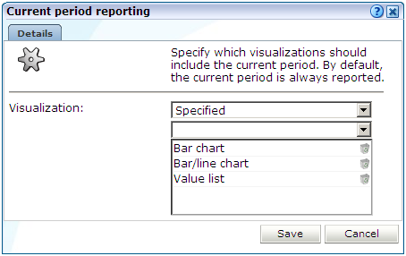

Specifying When Incomplete Periods Should be Reported
To specify when incomplete periods should be reported, do the following:
Select Configuration, then General, then Advanced settings, then Data visualization, and then Current period reporting. The dialog shown in Figure 9-29 appears.
Figure 9-29 Current Period Reporting Dialog
Select the visualization scheme to be used when reporting the current period. The following options are available:
Enabled: specifies that all incomplete periods should be reported within all graphical visualizations, as well as value lists, reports, and exports. This is the default.
Disabled: specifies that no incomplete period should ever be reported.
Specified: specifies that incomplete periods should only be reported within the specific visualizations. Note that the "Value list" option covers not only value lists within the Data Browser, but also reports and exports.
When ready, click Save. Any change you make to this setting takes effect immediately.

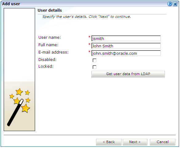

To create a new user, do the following:
Select System, then User management, and click the Add new user command button in the taskbar (see Figure 9-31). If an LDAP server connection has been configured (as described in Section 9.19.5, "Configuring LDAP Server User Authentication"), the dialog shown in Figure 9-33 appears. Otherwise, a dialog similar to the one shown in Figure 9-34 appears, and you should continue from step 3.
Use the radio buttons shown in Figure 9-33 to specify whether the creation of the new user account, and its associated user settings, should be authenticated against the settings held in the RUEI installation (this is the default), or against a configured LDAP server. When ready, click Next. If an LDAP server is configured, the dialog shown in Figure 9-34 appears. Otherwise, a dialog similar to the one shown in Figure 9-37 appears.
Use the dialog shown in Figure 9-34 to specify the following information for the new user:
The user name by which the user will be known within your RUEI installation. This must be a unique name. Users names are case sensitive. Note that if Oracle SSO server user authentication is enabled, the user is automatically created as an Oracle SSO user. In this case, specified user name must be the same as that defined within the Oracle SSO server.
The user's full name.
The user's E-mail address. This is the address to which reports and E-mail alerts will be sent. Ensure it is correct.
If the user will be authenticated against the settings held locally in the RUEI installation, you are required to specify and confirm a password for the new user. See Section 9.19.4, "Enforcing Password Security Policies" for information about password requirements. Note that the new password must be changed by the user within seven days or they are locked out.
Optionally, use the Disabled check box to disable the user at this time. You are free to enable them later.
If you selected user authentication against a configured LDAP server in Figure 9-33, you can click the Get user data from LDAP button to retrieve the user's settings from the configured LDAP server.
When ready, click Next to continue. The dialog shown in Figure 9-35 appears.

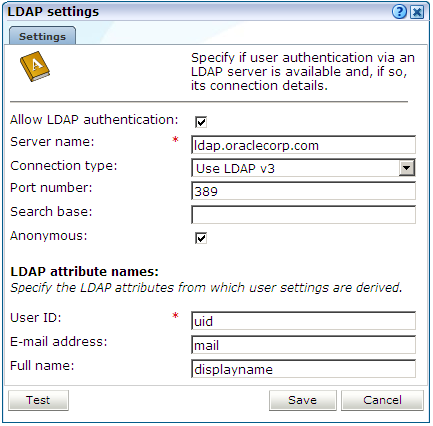

In order to provide enhanced security, RUEI can be configured to enable user authentication via an LDAP server, rather than through the settings held locally on your RUEI installation. If an LDAP server connection has been configured, you can specify the authentication method to be used for each defined user. Note because the admin user is predefined, and their password is set during initial configuration (see the Oracle Real User Experience Insight Installation Guide), only local authentication is available for this user.
If you plan to use LDAP authentication, it is recommended that you define your LDAP connection before the creation of user accounts. This is in order to prevent having to modify previously specified user settings.
Configuring the LDAP Server Certificate
Note that the LDAP secure server certificate should to in PEM format, and be specified via the TLS_CACERT directive in the /etc/openldap/ldap.conf file. The certificate file must be owned by the root user, and be readable by the RUEI and Apache user groups. Note that the CN of the LDAP server certificate must match the fully qualified domain name of the LDAP server.
Troubleshooting LDAP Connection Problems
If the LDAP secure server certificate configuration procedure described above does not provide a working connection, you can use the OpenLDAP utility (available on the Oracle Linux or RedHat Enterprise Linux distribution set) to validate the configuration of your LDAP server. The utility can be installed and run using the following commands:
sudo yum install openldap-clients
ldapsearch -x -P 2 -H "LDAP_server_URL" -D
cn=jsmith, dc=oracle, cn-com
where LDAP_server_URL specifies the full URL for your LDAP server, and the pair combinations depends on your LDAP server configuration. If specified correctly, information about that user is returned from the LDAP server. Otherwise, the problem encountered (such as the specified host name does not match the LDAP server or LDAP certificate was not installed correctly) is reported.
Note that if the certificate does not work, you can set the TLS_REQCERT directive to 'never' in the /etc/openldap/ldap.conf file to prevent validation of the certificate and continuation with the secure connection.
Configuring the LDAP Server Connection
To enable LDAP server authentication, do the following:
Select System, then User management, and then click Configure LDAP connection. Note that if an LDAP server connection has already been configured, the option is indicated as Modify LDAP connection. The dialog shown in Figure 9-40 appears.
Use the Allow LDAP authentication check box to specify whether an LDAP server is available for user authentication. The default is unchecked (disabled).
Use the Server name field to specify the host name or IP address of the LDAP server to be used. Note that protocol information (such as LDAP://) should be omitted from the server name.
Use the Connection type menu to specify the LDAP version and connection method. The default is V2 (non-secure).
Use the Port number field to specify the port to which the LDAP server is listening. If necessary, discuss this with your System Administrator. The default port is 389 or 636 (for SSL encryption).
Use the Search base field to specify the location in the directory structure within which the user ID needs to be unique. This must be a valid DN. For performance reasons, this should be as specific as possible. The default is the root of the directory tree.
Use the Anonymous check box to specify if the LDAP server lookup should be performed using an anonymous user. If unchecked, then a valid Distinguished Name (DN) must be specified, and the password for that user is requested when a new user is created. The default is to use an anonymous lookup.
Use the User ID, Email address, and Full name fields to specify the attributes that should be used to extract user settings from the LDAP server. The defaults are based on standard LDAP functionality. If necessary, you should discuss these attributes with your LDAP administrator.
Optionally, you can click Test to verify whether a working connection to the LDAP server can be made. This is discussed in the following section.
Any changes you specify to the LDAP configuration settings take effect immediately.

This section presents an outline of a BI solution utilizing data from the Enriched data exchange facility. In this case, it makes use of Oracle Business Intelligence foundation (part of the Oracle Fusion Middleware product family). Its schematic structure is shown in Figure 9-43.
Figure 9-43 Schematic Overview of Data Warehouse Staging Area
The framework is based on Oracle Warehouse Builder (OWB). The RUEI-captured data is exported to a database. From the export database, it is uploaded via SQL scripts to a staging database. This then populates the production database. Once in the production DWH, the RUEI data is available through a wide variety of reports and dashboards. An example of these reports is shown in Figure 9-44.

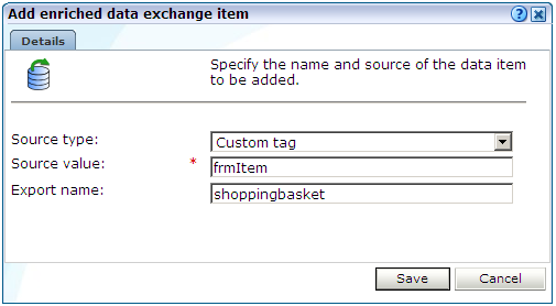

Figure 9-46 Add Enriched Data Export Item Dialog
Use the Source type menu to define how the required item should be identified within the data collected by RUEI, and the scope of the search. You can specify to search within the client request header or server response header, using either a literal search or an XPath expression, or to search within a custom page-tagging implementation for a specific tag. Further information about support for custom page-tagging schemes is available in Appendix A, "Tagging Conventions".
Use the Source value field to specify the specific argument or element from which the data item's value should be taken.
Use the Export name field to specify the name to be assigned to the data item. This becomes the item's element name. In the case of a custom tag, this will appear in the CONTENT column in the BI__BIDATA_MASTER (see Table R-2) in the format &name=value=. Similarly, XPath expression items would be reported in the REQUEST_HEADERS or REPLY_HEADERS columns. Note that the Export name field is not available if you select a header-related option in the Source type menu. In this case, the name of the header is used in the appropriate column. When ready, click Save. The new item, if found in the monitored traffic, will start to appear in the reported data within 5-10 minutes.
Existing data items can be modified by right-clicking them within Figure 9-45, and selecting Edit. You can also select Remove to delete it, or select Remove all to delete all currently defined items.
