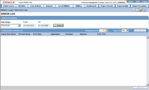

The Error Log screen provides information about errors that occurred during case processing.
To view the error log
Select Utilities --> Logs --> View Error Log.
The system opens the Error Log screen.
In the Search Conditions section, enter or select a date range and click Search.
The system displays the search results in the Total Number of Rows section.
Locate the error log you want to view and click to view the error message text.
The Search Conditions section enables you to search for error logs based on pre-defined or custom date ranges.
The following table lists and describes the fields in the Search Conditions section.
The system retrieves the error logs for the specified date range and places the results in the Total Number of Rows section.
The following table lists and describes the fields in the Total Number of Rows section.
| Field | Description |
| Total Number of Rows | Displays the total number of rows in the list. |
| Argus User Name | Displays the Argus User Name of the user who got the error. |
| OS User Name | Displays the OS User Name of the user who got the error. |
| Error Date | Displays the date and time of the error. |
| Application | Displays the name of the application where the error occurred. |
| Terminal | Displays the name of the terminal where the error occurred. |
| Machine | Displays the name of the machine where the error occurred. |
| Error Text | Displays the text of the error.
Note: click the Zoom icon to view the complete text. |
| Print List button | Prints the list of all the errors. |
