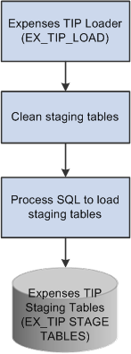

Using the Expenses Transaction in Progress (EX_TIP_LOAD) Application Engine Batch Process
The Expenses Transaction in Progress Loader application engine (EX_TIP_LOAD) enables users to run a batch process to load a large amount of transaction in progress data from PeopleSoft Expenses. Using this process decreases the amount of time it takes to load the transactions in progress from the feeder systems to the TIP staging tables and display them in the Project Costing Transaction in Progress page.
When the EX_TIP_LOAD application is run, it deletes the staging tables, inserts any new TIP exceptions, and populates the EX_TIP staging tables so that you can search for and display these PeopleSoft Expenses transactions in progress on the Transactions in Progress page in PeopleSoft Project Costing.
This diagram describes the Expenses TIP Loader process flow to the staging tables.
PeopleSoft Expenses TIP

 Run the Expenses Pagelet Processing process to convert expense data to various currencies and summarize the information. The Expenses Transaction in Progress Loader application engine (EX_TIP_LOAD) enables you to run a batch process to load a large amount of transactions in progress data from PeopleSoft Expenses in order to decrease the amount of time it takes to load the transactions in progress from the feeder systems to the TIP staging tables and display them in the Project Costing Transaction in Progress page .  |

 Go to Expenses Pagelet Processing (Travel and Expenses, Real-Time Analysis, Update Expenses Pagelet Info, Expenses Pagelet Processing)  |
 Click to run the process that populates the tables that enable you to view transactions in progress data and pagelets. When you run Expenses Transaction in Progress Loader application engine (EX_TIP_LOAD), you can run a batch process to load a large amount of transactions in progress data from PeopleSoft Expenses. This decreases the amount of time it takes to load the transactions in progress from the feeder systems to the TIP staging tables and display them in the Project Costing Transaction in Progress page.  |
