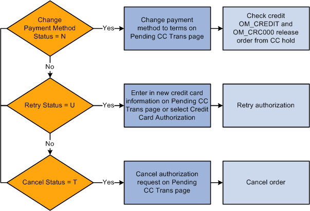

Processing failed credit card authorizations in PeopleSoft Order Management (1 of 2)
Processing failed credit card authorizations in PeopleSoft Order Management (2 of 2)

Changing Processing Parameters for Pending
Transactions
Access the Credit Status page (click the Credit Status link on the Pending CC Trans page). Select an option in the Actions group box to intercede in credit card processing:
Sets the authorization status to Unproc/Ret. You can reauthorize the same credit card or enter a different credit card number. The CC Processing process picks up the transaction the next time you run the process and resubmits the credit card amount for batch authorization. If using online authorization, you can click the Authorize Credit Card link to reauthorize the failed transaction. |
Removes the transaction from credit card processing. You can change the payment method from credit card to payment terms. Once you change the order to payment terms, the system checks the credit limit and Receivables balance before the order is released. |
The credit card amount for the order will not be reauthorized. The order must be canceled on the Order Entry Form page. |
