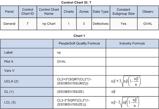

Control Chart ID: 7
This graphic displays Control Chart ID 7:
Control Chart ID: 7
