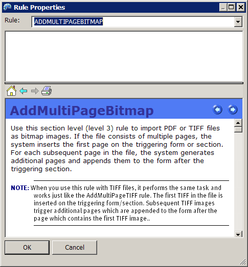

The following pages list and explain the various section rules you can use. The rules are discussed in alphabetical order on the pages following this table.
You can also see information about the section rules while using Studio when you select the rule on the Rule Properties window:
The following table lists the rules discussed in this section.
