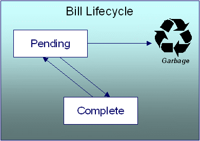

The following diagram shows the possible lifecycle of a bill.
This explanation only makes sense in the context of the page used to maintain bills. Refer to Bill - Main Information for the details.
A bill is initially saved in the Pending state. You may create one or more bill segments for the account's obligations at this point. Refer to How To for information about generating bill segments for the bill.

The bill's status becomes Complete.

If the system cannot complete the bill (for whatever reason), the bill remains Pending and an error message is shown on the main bill page. After correcting the cause of the problem, attempt to complete the bill again.
A complete bill may be changed back to pending using the Reopen button on Bill - Main Information. You would reopen a bill when

You may delete a Pending bill from the database. You may not delete a pending bill if: a) there are frozen bill segments linked to the bill, or b) if financial transactions were linked to the bill (and this can only happen if the bill had been previously completed).
In addition to removing the bill, the system will also remove unfrozen bill segments linked to the bill.
