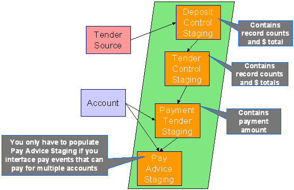

Process X refers to the mechanism used by your organization to populate the various staging tables (shown in the orange section of the following ERD).
The topics in this section describe each of these tables.
