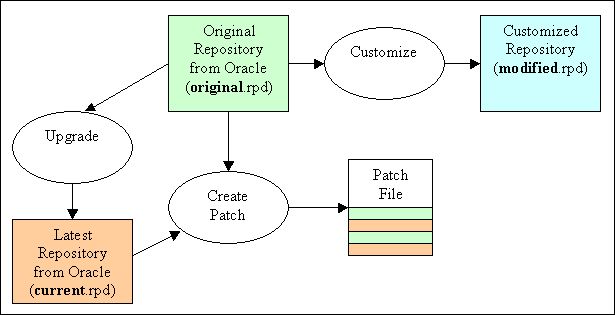

If you are using an Oracle BI Applications repository and have customized its content, you can use this option to compare your customized repository to a new version of the repository received with Oracle BI Applications.
See "Merging Repositories" for more information about merging your customized Oracle BI Applications repository with a new version of the repository.

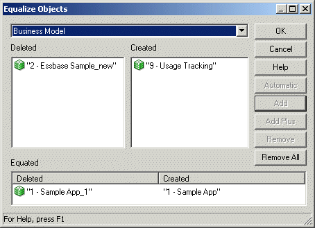

  5. Click Equalize to display the Equalize Objects dialog.
  6. The Equalize Objects dialog shows a list of changes where you may want to consider objects with different upgrade IDs to be the same object. You can use the following options to model how the changes might get equalized:
    • Click Automatic to automatically equalize changes related to objects that have the same name. The changes appear in the Equated table.
      If no changes can be automatically equalized, nothing appears in the table, and the OK button remains disabled.
    • Select an object in the Deleted list, then select the equivalent object in the Created list and click Add or Add Plus to equate the objects. Add Plus adds the object along with its child objects to the Equated table, while Add simply adds the selected object. For example, if you select a Subject Area and click Add Plus, the underlying Presentation Tables and Presentation Columns are added as well.
      After you make a manual selection, the Automatic button is disabled.
    • Select a row in the Equated table and select Remove or Remove All to remove objects from the Equated table. Remove All removes the object along with its child objects, while Remove simply removes the selected object
      The Automatic button is enabled after all manual selections are removed.
  7. When you are finished modeling the changes, click OK. The changes appear in the Compare Repositories dialog, but the changes do not persist after you close the dialog.

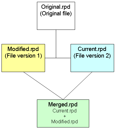

  • Common Parent. This merge, also called a three-way merge, is useful when you have a common parent repository and two derived repositories (see Figure 16-3). There is a parent (original) RPD, and two derived RPDs (file version 1 and file version 2). After the merge, a fourth merged repository file is created.
    Figure 16-3 Full Merge With a Common Parent

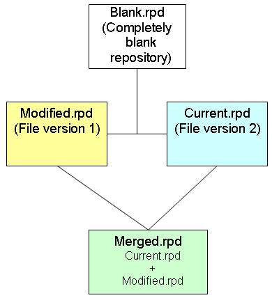

  • No Common Parent. This merge, also called a two-way merge, is useful when you want to import objects from one repository to another. In this case, objects are merged from two different repositories with no common parent. To accomplish this, you perform a three-way merge in the Administration Tool with a completely blank repository as the original file (see Figure 16-4). This functionality replaces the Import from Repository feature that was deprecated in an earlier release.
    Figure 16-4 Full Merge Without a Common Parent

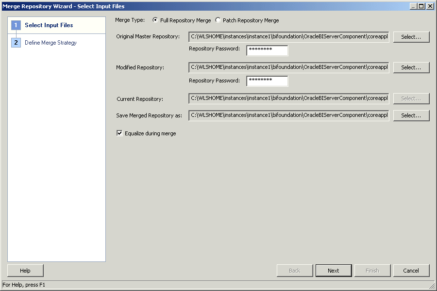

    Figure 16-5 shows the Merge Repository Wizard.
    Figure 16-5 Merge Repository Wizard: Select Input Files Screen (Full Merge)
    Description of Figure 16-5 follows
    Description of "Figure 16-5 Merge Repository Wizard: Select Input Files Screen (Full Merge)"
  3. In the Select Input Files screen, for Merge Type, select Full Repository Merge.
  4. Select the original parent repository by clicking Select next to Original Master Repository. Browse to select the original repository, then click Open.
  5. Provide the password for the original repository in the appropriate Repository Password field.
  6. Select the modified repository by clicking Select next to the Modified Repository field. Browse to select the modified repository, then click Open.
  7. Provide the password for the modified repository in the appropriate Repository Password field.
  8. Optionally, you can change the default name and location of the saved (merged) file by clicking Select next to the Save Merged Repository as field. Provide a new name and location, then click Save.
  9. It is a good practice to equalize your changes to clean up underlying object IDs before merging. If you have not yet equalized your changes, select Equalize during merge to equalize objects as part of the merge process. Selecting this option may affect merge performance.

Performing Full Repository Merges Without a Common Parent
This section explains how to use the Administration Tool to perform a full repository merge without a common parent. Use this method when you want to import objects from one repository (the modified repository) into another (the current repository).
In the repository you choose to define as current, make sure that the Presentation layer references any Physical layer or Business Model and Mapping layer objects that you want to keep. Objects like business models, databases, and connection pools in the current repository that are not referenced by any Presentation layer objects are discarded during the merge. If necessary, you might want to add a placeholder subject area that references the objects before you perform the merge to ensure the desired objects are kept.
See Appendix D, "Merge Rules" for more information about which objects are retained or discarded during the merge process.
To merge two versions of an Oracle BI repository file without a common parent:
  1. If you do not already have a blank repository file to serve as the original repository in the merge, create one, as follows:
    1. In the Administration Tool, select File, then select New Repository. The Create New Repository Wizard appears.
    2. Provide a name for the repository (for example, blank.rpd).
    3. For Import Metadata, choose No.
    4. Enter and confirm the repository password you want to use for this repository.
    5. Click Finish.
  2. Close the blank repository.
  3. Open the current repository in offline mode. This is the repository that contains the objects you want to import.
  4. From the Administration Tool menu, choose File, then select Merge. The Merge Repository Wizard appears.
  5. In the Select Input Files screen, for Merge Type, select Full Repository Merge.
  6. Click Select next to Original Master Repository. Then, browse to select your blank repository file as the original repository and click Open. Leave the password field blank.
  7. Select the destination repository by clicking Select next to the Modified Repository field. Browse to select the modified repository, then click Open. This is the repository into which you want to import objects.
  8. Provide a password for the modified repository in the appropriate Password field.
  9. Optionally, you can change the default name and location of the saved (merged) file by clicking Select next to the Save Merged Repository as field. Provide a new name and location, then click Save.
  10. Click Next. If there are any conflicts, the Define Merge Strategy screen of the Merge Repository Wizard appears. If there are no conflicts, the Merge Wizard continues with the merge process and then closes automatically when finished.
  11. The Define Merge Strategy screen displays a decision table that shows conflicts for this merge. To make decisions about whether to include or exclude objects from the merged repository, choose Current or Modified from the Decision list. When you select an object in the decision table, the read-only text box below the decision table describes what changes were made to that object in the current repository.
    Refer to Figure 16-6 to see the Define Merge Strategy screen. Refer to Table 16-3 for information about additional options in the Define Merge Strategy screen, such as saving merge decisions to a comma-separated values (.csv) file.
    After you make a merge decision, the row for that decision in the table changes from red to black. When all rows have a value in the Decision field, the Finish button is enabled.
  12. Click Finish.

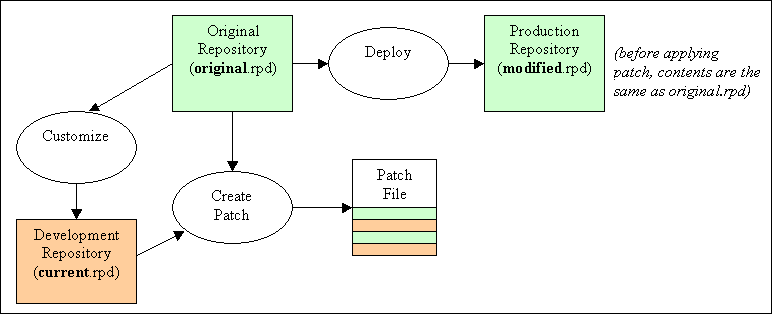

In a patch merge, you create a patch that contains the differences between the current repository file and the original repository file. Then, you apply the patch file to the modified repository file.

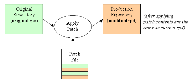

In a development-to-production scenario, you have an original parent file, a current file that contains the latest development changes, and a modified file that is the deployed copy of the original file.
To generate a patch, you open the current file and select the original file, then create the patch. Figure 16-7 shows how to create a patch in a development-to-production scenario.
Figure 16-7 Development-to-Production: Creating the Patch
Description of Figure 16-7 follows
Description of "Figure 16-7 Development-to-Production: Creating the Patch"

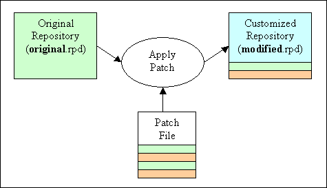

To apply the patch, you open the modified file and select the original file, then apply the patch. Figure 16-8 shows how to apply a patch in a development-to-production scenario.
Figure 16-8 Development-to-Production: Applying the Patch
Description of Figure 16-8 follows
Description of "Figure 16-8 Development-to-Production: Applying the Patch"
In an Oracle BI Applications repository upgrade scenario, the current file is the latest version of the repository shipped by Oracle, and the original file is the original repository shipped by Oracle. The modified file is the file that contains the customizations you made to the original file.
To generate a patch, you open the current file and select the original file, then create the patch. Figure 16-7 shows how to create a patch in an Oracle BI Applications repository upgrade scenario.
Figure 16-9 Oracle BI Applications Repository Upgrade: Creating the Patch
Description of Figure 16-9 follows
Description of "Figure 16-9 Oracle BI Applications Repository Upgrade: Creating the Patch"
To apply the patch, you open the modified file and select the original file, then apply the patch. Figure 16-10 shows how to apply a patch in an Oracle BI Applications repository upgrade scenario.
Figure 16-10 Oracle BI Applications Repository Upgrade: Applying the Patch
Description of Figure 16-10 follows
Description of "Figure 16-10 Oracle BI Applications Repository Upgrade: Applying the Patch"

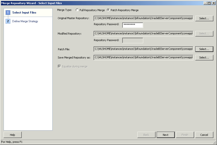

  1. In the Administration Tool, open the modified Oracle BI repository in offline mode. In other words, open the repository on which you want to apply the patch.
  2. Select File, then select Merge. The Merge Repository Wizard appears.
    Figure 16-11 shows the Merge Repository Wizard.
    Figure 16-11 Merge Repository Wizard: Select Input Files Screen (Patch Merge)
    Description of Figure 16-11 follows
    Description of "Figure 16-11 Merge Repository Wizard: Select Input Files Screen (Patch Merge)"
  3. For Merge Type, select Patch Repository Merge.
  4. Click Select next to Original Master Repository. Browse to select the original repository, then click Open. Note that the original repository cannot be the same as the modified (currently open) repository.
  5. Enter the repository password for the original repository.
  6. Click Select next to Patch File. Browse to select the patch file you want to apply, then click Open.
  7. Optionally, click Select next to Save Merged Repository as, then enter a file name under which the patched repository will be saved and click Save.
  8. Click Finish.
