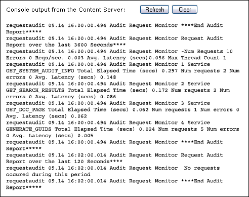

To view the Java output of the Oracle Content Server instance Admin Server:
Display the Admin Server Page.
Click the View Server Output link.
The Admin Server Output Page is displayed.
To refresh the output messages, click Refresh. To clear the output messages, click Clear.

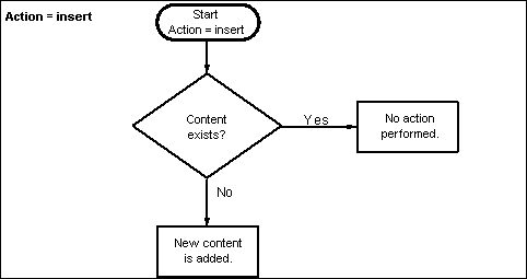

The insert action checks a new file into the Oracle Content Server repository. If the Content ID (dDocName) already exists in the Oracle Content Server database, no action is performed.Figure 3-1 illustrates the insert action.
Figure 3-1 The Insert Action Sequence for Checking In a New File

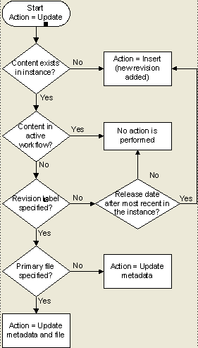

The update action updates existing content items. One of the following actions occurs, depending on what items are present in the file record and what content exists in the system:
A new revision of an existing content item is created.
An existing file's metadata is updated.
A new content item is inserted (Action=insert is performed).
Note: Batch loaded revisions will not enter a workflow even if they meet the criteria for an active workflow. |
A new revision is created when one of the following scenarios occur:
| Scenario | Content ID (dDocName) | Revision (dRevLabel) | Release Date in Batch Load file (dInDate) |
| Scenario 1 | Exists in Oracle Content Server instance | Not specified in the batch load file. | After the release date of the latest revision of the file in the system. |
| Scenario 2 | Exists in Oracle Content Server instance | Specified in the batch load file, but does not exist in the Oracle Content Server instance. | After the release date of the latest revision of the file in the system. |

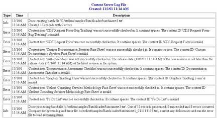

Open the Oracle Content Server log. Select Administration, then Log Files, then click Content Server Logs.
Look through the Type column for the word Error.
Read the description to determine the problem.
Fix the error in one of these files:
Batch load file
The error file for the failed content. (This option is available only if you enabled it on the Batch Loader Screen.) The error file is located in the same directory as the batch load file, with several digits appended to the batch load file name.
Tip: If you rerun an entire batch load file, content items that have already been checked in will usually fail. This occurs because the release dates of the existing content items will be the same as the ones you are trying to insert. |
Figure 3-4 Oracle Content Server log file

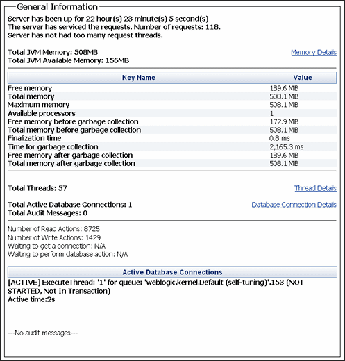

The General Information section of the System Audit Information page provides the following:
Information regarding whether the system is receiving too many requests. If it is receiving too many requests, an e-mail is sent to the system administrator regarding load performance.
Information about the memory cache for the system, and is useful in troubleshooting any "out of memory" errors you may receive. This is important when running the Oracle Content Server instance with many users and a large quantity of data.
Information about which Java threads are currently running. This is useful in determining the cause of an error.
Information about database activity.
Listing of any audit messages.
To display more information, click the link on the page for the type of configuration information.

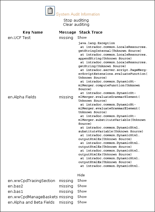

The Localization Information section of the System Audit Information page provides information on:
String key count
Whether the Localization system is using a string index
Localization test run time
Localization test lookups per second
Figure 3-6 System Audit Localization Information Screen

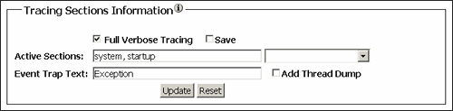

Tracing in the Oracle Content Server instance can be activated on a section-by-section basis. Tracing for active sections is displayed on the Server Output Page. Section tracing is useful for determining which section of the server is causing trouble, or when you want to view the details of specific sections. Sections can be added by appending extra sections to create a comma separated list. A listing of the sections available for tracing, with brief descriptions, is available by clicking the 'i' next to the Tracing Sections Information heading. The wildcard character * is supported so that schema* will trace all sections that begin with the prefix schema.
Some tracing sections also support verbose output. Enable Full Verbose Tracing if you want to see in-depth tracing for any active section that supports it. For more information, see Section 3.8.4, "Tracing."
Figure 3-7 System Audit Tracing Sections Information Screen
Important: Any options set here will be lost when the Oracle Content Server instance is restarted unless you enable Save and click Update. |

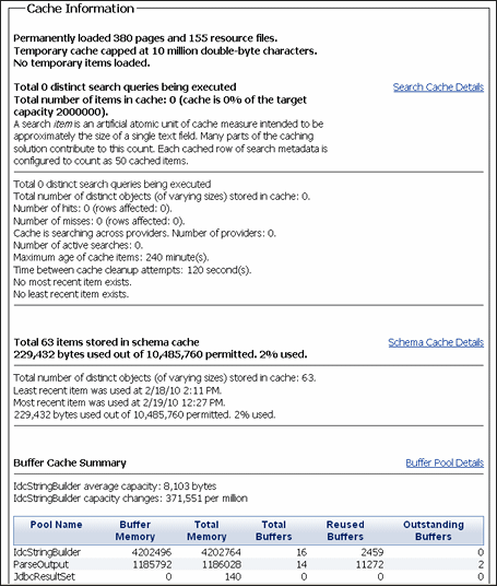

The Oracle Content Server instance caches various items for quick access. The Cache Information section displays current information of three main caches:
Searches: This pertains to the number of searches currently being run, how many executed searches are currently in cache, and when the cache is emptied. These details are useful when troubleshooting any search related issues.
Schema: This lists details of any schema items currently in cache.
Buffer: This displays information about Java objects in cache and how much memory each object is using, which is reflected in the memory information under the System Audit General Information section. This information can be useful in pinpointing which object may be responsible for any memory leaks or other memory issues.
To display more information, click the link for the type of cache information on the page.

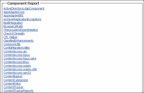

The Component Report Information section of the System Audit Information page provides the following information for components on the Oracle Content Server instance:
Location: pathname for the component in the instance
Version: date, build, and revision
Status: current status of the component (Loaded or Skipped)
Reason: an explanation of the component status
To display more information, click the link for the component name on the page.
Figure 3-10 System Audit Component Report Screen
The server output page displays the console output of the Oracle Content Server instance. This is the same information that is located in the DomainHome/ucm/cs/bin/classname.log file. It includes information pertaining to all the sections selected for audit tracing in the System Audit Tracing Sections Information. To access the Server Output page, click View Server Output on the System Audit Information page.

You can activate Oracle Content Server tracing to display detailed system information that may be very useful for troubleshooting and optimizing system performance. There are two tracing options:
Server-wide tracing is used to view activities throughout the system.
There are two ways to activate server-wide tracing. To activate tracing from the Administration page, complete the following steps:
Ensure that you are logged on to the Oracle Content Server instance as an administrator.
Click the System Audit Information link in the Administration tray.
Enable Full Verbose Tracing to see in-depth tracing for any active section that supports it.
Specify the traces to activate.
Click Update.
Click View Server Output.
Tip: Tracing options are lost on system restart. To ensure your settings are retained after restarting the Oracle Content Server instance, enable Save before clicking Update. |

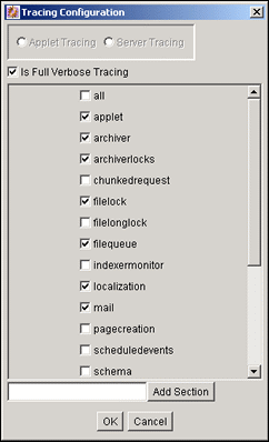

To activate tracing from an applet, follow these steps:
Start an administrative applet.
Select Options and then Tracing.
Select Server tracing.
Select the tracings to activate or all and click OK.
The following tracing options are available. Additional tracing sections can be displayed in the list if components are added.

docprofile: This trace displays the computation of content profiles, specifically the evaluation of the rules that determine which fields are labels, hidden, and so on.
encoding: This trace provides information about encoding transformations that have occurred and the activities where encoding occurred.
filelock: This trace displays information about short-term system locks put on directories (during activities like archiving, for example) with a focus on collisions that occur and time outs.
filelonglock: This trace displays information about the creation, removal, and maintenance of long term locks imposed by the system.
filequeue: This trace displays information about accesses to a file queue.
indexer: This trace displays information about index functions that occur when the database is updated, including the steps taken to update the index and the time elapsed for each step.
indexermonitor: This trace provides a brief summary of automatic index activities, including time started and ended.
indexerprocess: This trace displays information about a manually launched index process and indicates if the process terminated properly.
localization: This trace displays information about localization usage and activities.
mail: This trace describes mail sent by the Oracle Content Server instance.
pagecreation: This trace displays information about the creation of displayed pages, including the server thread and the time taken to generate the page.
requestaudit: This trace provides summary reports on service requests, including the elapsed time for the requests and the number of requests made.
scheduledevents: This trace provides a list of hourly or daily background scheduled events.
schema: This trace provides information about schema publishing (tables and views published as .js files) and caching (tables cached into Oracle Content Server memory).
searchquery: This trace displays information about recent searches, including the fields used to search on and the order of sorting for results.
socketrequests: This trace displays the date, time, and thread number of socket requests and the actions during the request.
system: This trace displays internal system messages, such as system socket requests and responses.
systemdatabase: This trace provides information about database activities, including queries executed, index updates, threads used, and time initiated.
transfermonitor: This trace displays information about the archiver and the batch file transfer activities.
userstorage: This trace describes the access of external user repositories, including what actions were taken during access.
workflow: This trace displays a list of metadata on content items going through workflow, including document title and revision number.
Note: To facilitate international support, most tracing messages are in English and do not have translations. |
For applet-specific tracing, the output goes to the browser Java console. To perform tracing by applet, complete the following steps:
Start the administration applet to be traced.
Make your selections, and click OK. The output is directed to the browser Java console.

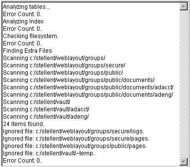

The Content Server Analyzer: Progress Tab is displayed automatically when the Start Analysis button is clicked. The progress bars show when the Content Server Analyzer has completed processing the selected analysis options. The following image shows a partially finished analysis:
When the analysis process is complete, the results are displayed in the console area of the Progress tab. The results depend on what analysis options were selected. The following image of the console area shows the results from selecting database, search index, and file system options:
Note: The Generate report option was not selected for this example. For an example of the generated status report, see Section 3.8.6.8, "Generating a Status Report." |
Figure 3-14 Example Console Display of Results

The Oracle Content Server system also provides a debugging configuration variable that, when set, contributes applicable diagnostic information. The configuration variable is named IsDevelopmentEnvironment, and it is set in the Oracle Content Server instance's configuration file (IntradocDir/config/config.cfg) during installation and when the Oracle Content Server instance is updated. This entry does the following:
Defines whether the Oracle Content Server instance should run in debug mode.
Enables a trace of script errors. If used as a parameter to a service call, script error information can be added to the bottom of the displayed page.
Another debug configuration variable is named AlwaysReportErrorPageStackTrace. When this variable is set, whenever an error occurs the stack trace is reported on the browser showing the Oracle Content Server user interface.
Note: For further details refer to the Oracle Fusion Middleware Idoc Script Reference Guide. |
The stack trace enables you to see what threads are currently running in the Oracle Content Server instance. It is a useful troubleshooting tool that provides information about the threads and enables you to monitor the Oracle Content Server system's processing.
For instructions to initiate a current stack trace for the Oracle Content Server instance, see Oracle WebLogic Server documentation.
