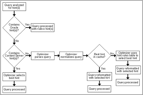

The stages of the optimization process are completed in the following sequence:
The submitted query is analyzed to verify if it contains one or more hints and, if so, determine the type of hint; see "Stage 1: Query Analysis".
If the query's WHERE clause does not contain a hint, the optimization feature must parse out the WHERE clause; see "Stage 2: Parsing".
After parsing, each condition in the query's WHERE clause is evaluated against the Hint Rules Table in an attempt to qualify the condition and normalize the query; see "Stage 3: Normalization".
After the WHERE clause conditions are qualified and the query is normalized, a hint is selected or retrieved from the hint cache; see "Stage 4: Select Hint".
The query is reformatted using the selected hint; see "Stage 5: Reformat Query".

Oracle Query Optimizer also contains a hint cache to store dynamically generated hints. For example, a hint derived from a parsed query or data source is cached to maintain persistence. In this way, the hint cache provides stability for queries and data sources.
The hint cache is used during the optimization process to select hints for queries that do not contain Oracle or Content Server hints. The hint cache provides a mechanism to fine tune query hints. In addition, administrator can check/edit cache and change hint for queries at run time.
The hint cache is stored to disk every two hours and is reloaded when the Oracle Content Server instance is started.
The characteristics of the hint cache include:
The same query matches the same cache entry regardless of its values unless the new value does not satisfy the hint rule conditions. Two examples are included below to demonstrate how the same hint cache entry can and cannot be used for multiple queries.

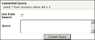

To access the Query Converter page, select Administration, then Oracle Query Optimizer, then Query Converter. The Query Converter Page is displayed.
The following tasks are involved when you use the Query Converter:

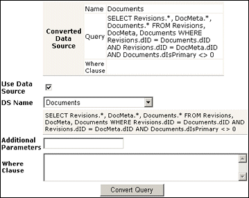

To convert a data source query.
If applicable, select Use Data Source.
The data source-related fields are displayed on the Query Converter page.
Select the desired data source from the DS Name menu.
The data source query is displayed in below the DS Name field.
Enter the applicable information for additional parameters and WHERE clauses.
Click Convert Query.
The data source is converted and the results are displayed in a text area above the Use Data Source checkbox. To view an example of a converted data source query, see Figure 4-4.
To convert a query:
If applicable, unselect Use Data Source.
The data source-related fields are hidden from the Query Converter page.
Enter the applicable information for the query.
The query is converted and the results are displayed in a text area above the Use Data Source checkbox. To view an example of a converted query, see Figure 4-5.
Figure 4-4 Example of Converted Data Source Screen
Figure 4-5 Example of Converted Query Screen
After the data source or query is converted, the results are displayed above the Use Data Source checkbox. Because the conversion process clears the fields, the converted query can only be modified by entering new information in the fields. To edit information for a data source or query, see the applicable sections in Section 4.2.5.12.1, "Converting a Data Source."

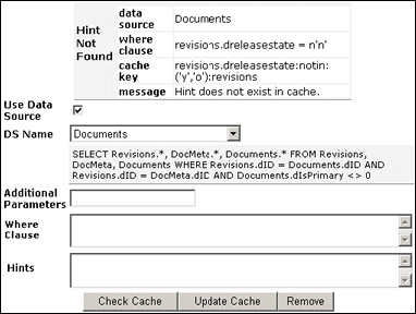

To check the hint cache using a data source:
On the Hint Cache Update page, select Use Data Source.
The data source-related fields are displayed on the Hint Cache Updater page.
Enter the applicable information for the additional parameters, WHERE clause, and hints.
Click Check Cache.
The results are displayed above the Use Data Source checkbox. To view an example of an unsuccessful hint search, see Figure 4-6.
Figure 4-6 Example of Hint Cache Updater Results with Data Source

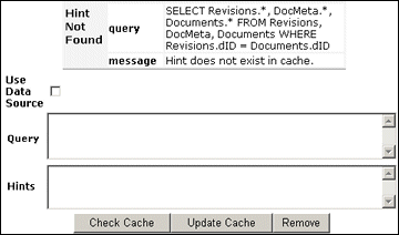

To check the hint cache using a query:
On the Hint Cache Update page, ensure the Use Data Source checkbox is unselected.
Enter the applicable information.
Click Check Cache.
The results are displayed above the Use Data Source checkbox. To view an example of an unsuccessful hint search, see Figure 4-7. To view an example of a successful hint search, see Figure 4-8.
Figure 4-7 Example of Hint Cache Updater Results without Data Source

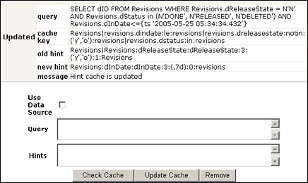

To modify a hint cache using a query:
On the Hint Cache Page, ensure that the Use Data Source checkbox is unselected.
Click Update Cache to overwrite the previous hint cache.
The results are displayed above the Use Data Source checkbox. In the screen capture note that the new hint was added and the hint cache was updated.
Figure 4-9 New hint added, hint cache updated

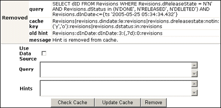

To remove a hint cache query:
On the Hint Cache Updater page, ensure that the Use Data Source checkbox is unselected.
Enter the applicable information for the query and hints.
Click Remove.
The results are displayed above the Use Data Source checkbox. In the screen capture note that the previously added hint was deleted from the query and hint cache.
Figure 4-10 Example of a deleted hint from cache
