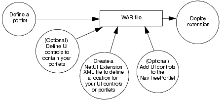

Figure 6-1 illustrates the process. The steps in the process, and the results of each are described in Table 6-1. Subsequent sections detail each step in the process.
Figure 6-1 Adding Portlets and Navigation Controls Development Overview
Description of Figure 6-1 follows
Description of "Figure 6-1 Adding Portlets and Navigation Controls Development Overview"
Table 6-1 Model MBean Development Tasks and Results
Step Description Result
1. Define a Portlet.
Create an XML file to define a portlet that the portal framework can instantiate. A portlet definition includes instructions on which type of data to load: JSPs, Struts Actions, or Beehive Page Flows.
The portal's Look and Feel determines whether the portlet provides borders and minimize/maximize controls.
A .portlet XML file.
2. Define UI Controls (Optional).
If you want your portlet to display in a tab, subtab, or in some other location within ContentBook, create an XML file that defines a page or book.
A .book XML file.
3. Specify a Location for Displaying Portlets or UI Controls.
Create an XML file that describes whether you want your portal to display next to a labeled UI control or to replace the control.
A netuix-extension.xml file.
4. Add Nodes to the NavTreePortlet (Optional).
You can create a link from the NavTreePortlet to any book or page in your extension.
WebLogic Server provides default support for appending control names to the end of the existing navigation tree. If you want to insert nodes in specific locations, or if you want to create a node tree, you create your own Java classes that describe the node and node location.
Additional entries in the .book XML file.
Optionally, Java classes that give you more control over the node that you are adding.
5. Archive and deploy the extension.
See Chapter 9, "Archiving and Deploying Console Extensions."
A WAR file that contains your extension.
