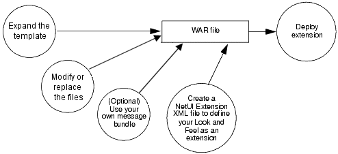

Figure 5-1 illustrates the process. The steps in the process and the results of each are described in Table 5-1. Subsequent sections detail each step in the process.
Figure 5-1 Administration Console Extension Development Overview
Table 5-1 Rebrand the Administration Console: Tasks and Results
