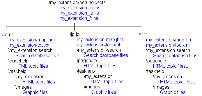

For an extension's help to be merged with the main console help, the help files must be organized as follows. The name of the directory containing the helpset files must be bea-helpsets
...\console_extension\bea_helpsets\extension_name_locale.hs ...\console_extension\bea_helpsets\locale\extension_name-map.jhm ...\console_extension\bea_helpsets\locale\extension_name-toc.xml ...\console_extension\bea_helpsets\locale\extension_name-search\search database files ...\console_extension\bea_helpsets\locale\topics_dir\HTML topic files... ...\console_extension\bea-helpsets\locale\topics_dir\images\Graphic files... ...\console_extension\PortalConfig\... ...\console_extension\WEB-INF\... ...\console_extension\Other extension source directories...
Note: The HTML topic files and graphic files may be located in multiple directories and subdirectories, but they all must be under...\ console_extension \bea_helpsets\ locale \. |
For example:
...\my_ext\webapp\bea_helpsets\my_ext_en_US.hs ...\my_ext\webapp\bea_helpsets\en_US\my_ext_map.jhm ...\my_ext\webapp\bea_helpsets\en_US\my_ext_toc.xml ...\my_ext\webapp\bea_helpsets\en_US\my_ext-search\search database files... ...\my_ext\webapp\bea_helpsets\en_US\pagehelp\HTML topic files... ...\my_ext\webapp\bea_helpsets\en_US\taskhelp\HTML topic files... ...\my_ext\webapp\bea-helpsets\en_US\taskhelp\images\Graphic files... ...\my_ext\webapp\jsp\... ...\my_ext\webapp\PortalConfig\... ...\my_ext\webapp\WEB-INF\...
Multiple localized helpsets can be simultaneously included in help. The help viewer uses the same strategy used by java.util.ResourceBundle
for locating locale-specific help files. The help viewer expects the following directory structure under the bea-helpsets
directory for your extension:
...\extension_name_locale_1.hs
...\extension_name_locale_2.hs
...\extension_name_locale_3.hs
...\locale_1\
map
.jhm
...\locale_1\
toc
.xml
...\locale_1\
search
Search db files...
...\locale_1\
topics
HTML topic files...
...\locale_1\
topics
\images\
Graphic files...
(optional) ...\locale_2\
map
.jhm
...\locale_2\
toc
.xml
...\locale_2\
my_search
Search db files...
...\locale_2\
topics
HTML topic files...
...\locale_1\
topics
\images\
Graphic files...
(optional) ...\locale_3\
map
.jhm
...\locale_3\
toc
.xml
...\locale_3\
search
Search db files...
...\locale_3\
topics
HTML topic files
...\locale_3\
topics
\images\
Graphic files...
(optional)
For example, see Figure 8-1.
Figure 8-1 Directory Structure for Localized Help
If the help content for the locale specified in the browser is not found, the help viewer displays the content from the default folder.
