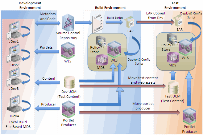

Although developers typically build and run locally, an automated nightly build environment is recommended. The build environment represents a clean deployment of the portal application.
To set up the build environment, back end servers and connections must be installed and created once. For example, the build environment requires WebLogic Server instance, and typically includes access to an installed UCM instance. In addition, the build environment includes a database-based MDS and policy store.
Figure 9-1 illustrates the general flow from development to build to test environments.
Note: Figure 9-1 does not depict all possible portal features. For example, WebCenter Personalization Service (WCPS) is not depicted in the diagram. For more information, see Section 9.12, "Building and Deploying WebCenter Personalization Service Files." |
Figure 9-1 Flow from Development to Build to Test Environments
A common practice is to use Ant-based build scripts to construct the EAR from source control and deploy it. The EAR includes metadata, code, and seeded policies. The build script also packages into the EAR metadata customizations made to portlets. See Section 9.7, "Configuring a Nightly Build Script." Some tasks performed by the build scripts include:

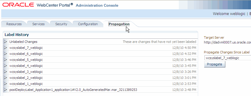

WebCenter provides a Propagation tool that is built in to the WebCenter Portal Administration Console. The Propagation tool is for moving your application from the staging environment to the production environment. See Section 9.13, "Using the Propagation Tool to Propagate From Staging to Production."

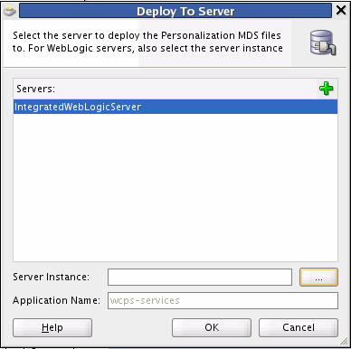

To deploy WCPS files to a server:
In JDeveloper, open your portal project. If you want to use WLST commands to perform this deployment, see Section 9.12.4, "Importing and Exporting MAR Files."
From the Application menu, select Deploy Personalization Files and then select To Server.
In the Deploy to Server dialog, select the server to which you want to deploy the service. See Figure 9-3.
Note: Optionally, click the Add button to add a server to the list. |
Click the "..." button to select a specific server instance. For example, the running DefaultServer.
Click OK when you are finished.
Check, the Message - Log window for details on the deployment. The log will indicate if the deployment of the metadata files was completed successfully.

WebCenter provides a propagation tool to move a portal metadata from staging to production. In practice, the staging environment and the production remain identical until changes are made to the staged portal. When the changes are tested and approved, an administrator uses the propagation tool to "push" the changes to the production server. This transfer does not require the production server to be restarted.
When properly configured, the Propagation tool shows up as a tab in the WebCenter Portal Administration Console, as shown in Figure 9-4.

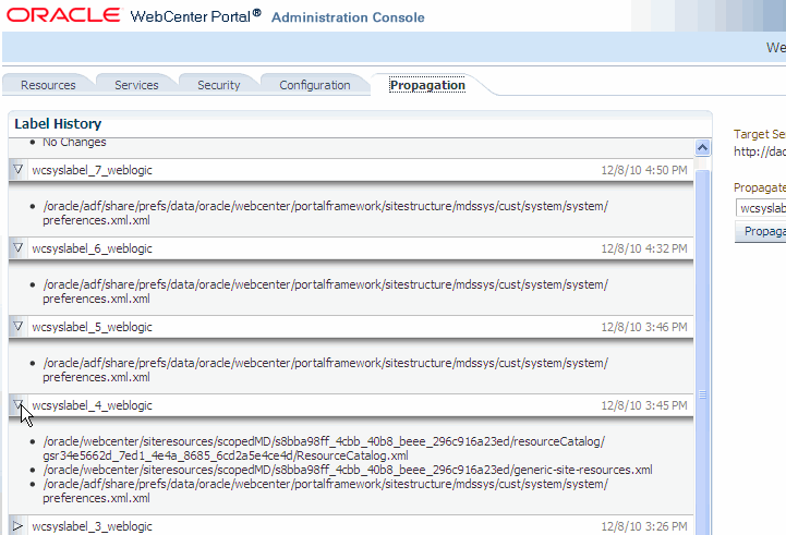

The Label History part of the Propagation tab lists the labels that were created for each propagation, labels created outside of the Propagation tab, such as labels created during deployment and labels created using WLST. Each label includes a list of files that change since the last propagation was performed. To view the contents of a label, click the arrow button to the left of the label name, as shown in Figure 9-5.
Figure 9-5 The Propagation Tab with Labels Opened
Note: If you are using the Propagation tool and if any of the MDS document file names contain multi-byte NLS characters, the stage machine should be configured for that NLS. |
The Propagation tab only shows up in the WebCenter Portal Administration Console if the portal deployed to the staging server has a URL Connection configured. This URL connection must point to the production server and it must be named ProductionURLConnection.

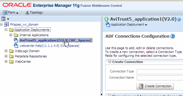

In a browser, open Oracle Enterprise Manager for your staging server domain. For details on starting Oracle Enterprise Manager, see Oracle Enterprise Manager Administrator's Guide.
In the navigation tree, open the Application Deployments folder and then open the Internal Applications folder.
In the Internal Applications folder, click on the application, as shown in Figure 9-6.
Figure 9-6 Selecting the Application in Enterprise Manager

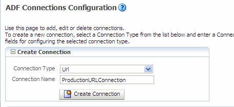

In the Create Connection box, select the URL connection type and enter ProductionURLConnection as the Connection Name. See Figure 9-7.
Note: You must name the connectionProductionURLConnection. The name is case sensitive. |
In the URL Connections box, click Edit.

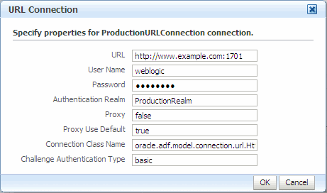

Complete the URL Connection dialog box as follows.
URL – Enter the URL (including hostname and port number) of the production server.
Username – Enter a username for the connection.
Password – Enter a password for the connection.
Authentication Realm – You must enter a value for the Authentication Realm. Do not leave this field blank. You can enter any arbitrary string, such as ProductionRealm.
You can accept the default values for the remaining fields. See Figure 9-8.
Click OK after you complete the URL Connection dialog.
Click Apply in the upper-right corner of the Enterprise Manager window.

Use the propagation tool when you want to move changes made on the staging portal to the production portal.
Be sure the propagation tool is configured, as described in Section 9.13.2, "Configuring the Propagation Tool." To use the propagation tool, you must have Administrator's privileges.
Open the WebCenter Portal Administration Console. By default, the administration console is located at this URL:
http://<server>:<port>/<context_root>/admin
For more information on using the WebCenter Portal Administration Console, see "Using the WebCenter Portal Administration Console" in the Oracle Fusion Middleware Administrator's Guide for Oracle WebCenter.
Select the Propagation tab.
Note: If you don't see the Propagation tab it could be because you don't have administrator's privileges or the propagation tool was not configured properly as explained in Section 9.13.2, "Configuring the Propagation Tool." |
Click Propagate to transfer the files to the production server.
