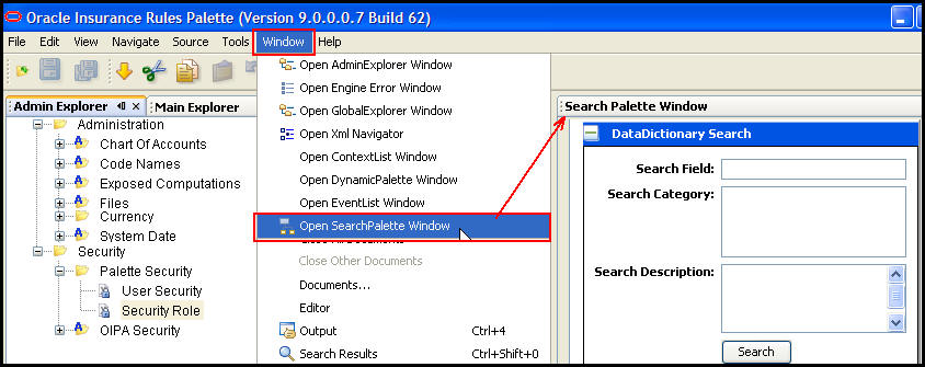

There are two ways to access the Data Dictionary:
When configuring, access the Data Dictionary by clicking
Window from the menu bar and selecting Open SearchPalette Window. Procedures
for using the drag and drop functionality in the Configuration Area are
described in the SearchPalette
Window description.
Window Option on Tool Bar with OpenSearchPaletteWindow Option Selected

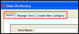

Security is wrapped around the Data Dictionary, allowing only users with the proper permissions to create and edit dictionary terms. There are three levels of Data Dictionary security: check-in/check-out, manager and view.
Open the Data Dictionary by clicking the Data Dictionary icon
on the Main Menu. There
are three tabs in the Data Dictionary window: Search,
Manage Term and Create New Category.
Search: use this tab to search for existing terms or add new terms.
Manage Term: use this tab to update existing terms or change the category a term is associated with.
Create New Category: use this tab to add new categories to the Data Dictionary.
Important: In the Data Dictionary the word term refers to either a field or math variable.
Data Dictionary Tabs
