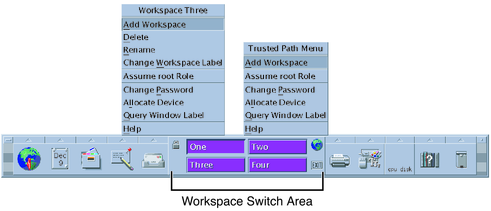

If you leave your workstation briefly, lock the screen.
Figure 3-1 Front Panel Switch Area
Figure 3-2 Lock Screen Selection

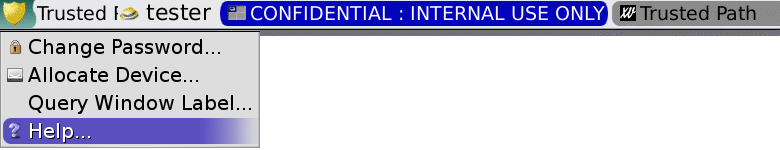

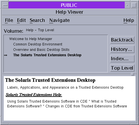

Figure 3-4 Trusted Extensions Online Help

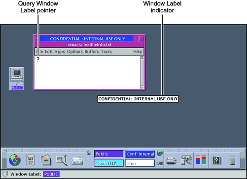

This operation can be useful to identify the label of a partially hidden window.
The pointer changes to a question mark.
The label for the region under the pointer is displayed in a small rectangular box at the center of the screen.
Figure 3-5 Query Window Label Operation
